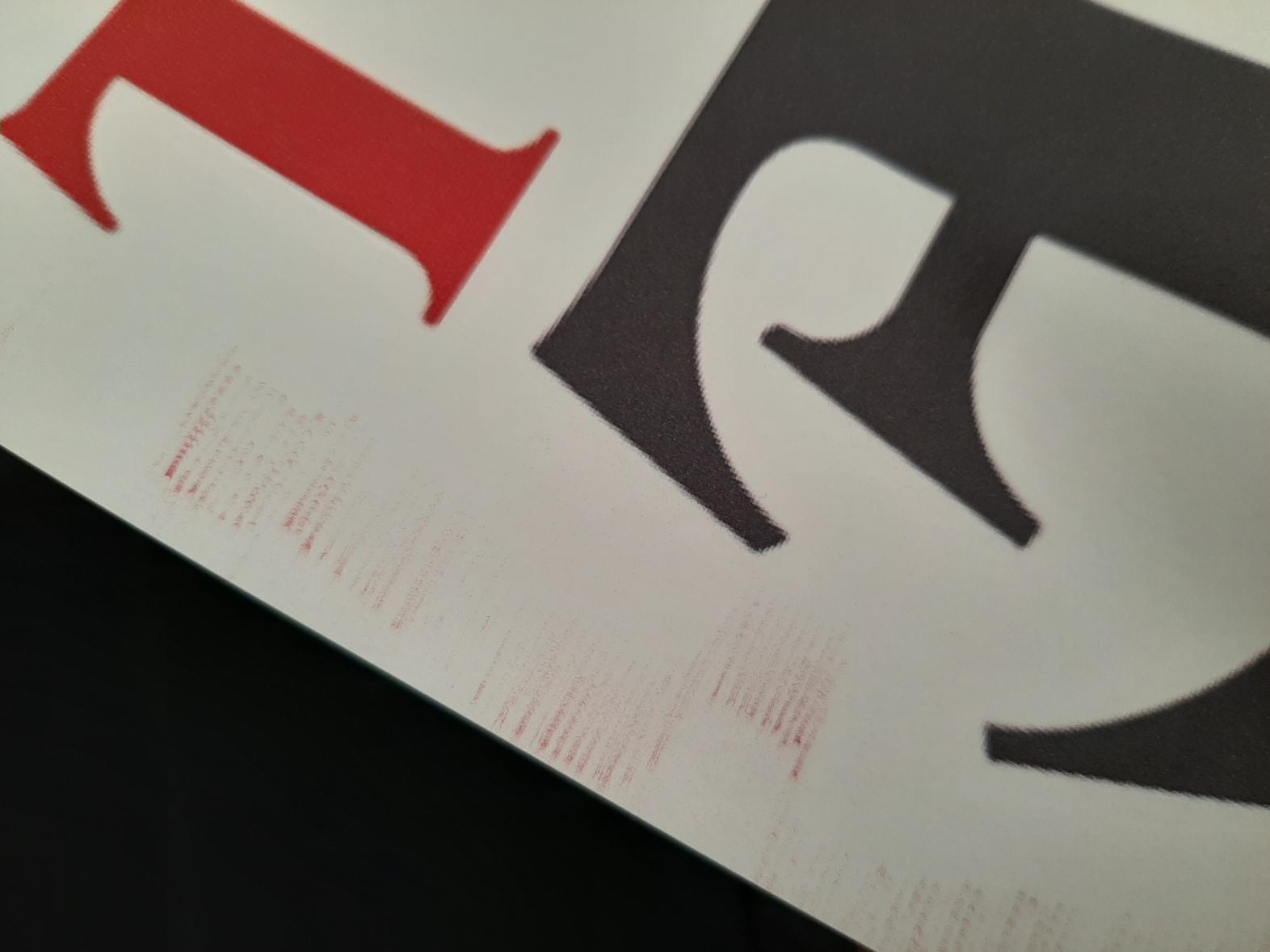

Hi when I'm printing my transfer paper I'm geting these lines on my paper any ideas

Post by Mrteajunkie »
Looks like the printer wheels are picking up ink.
I maybe wrong though.
try turning off high speed prints and try a lower print quality.
also run a few blank sheets of paper through the printer to clean off any residual ink. (Print a blank png)

Post by Timyb »
Hi thank you for your reply I'm only geting this issue when printing in relative colormetric if I try in absalute colormetic I dont get this problem but I need to be printing in relative colormetric I'm confused lol
