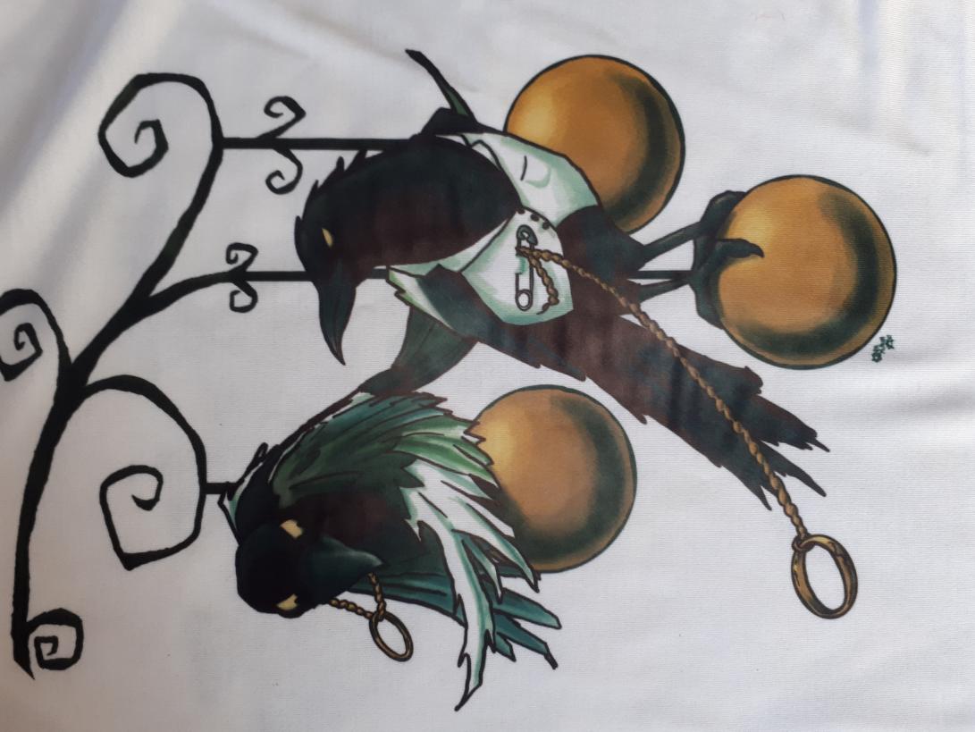

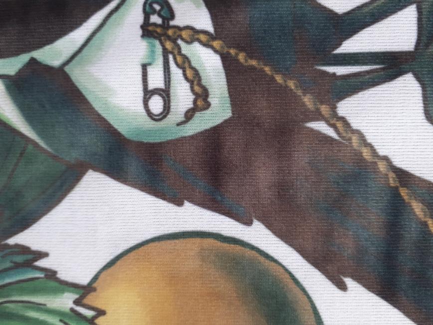

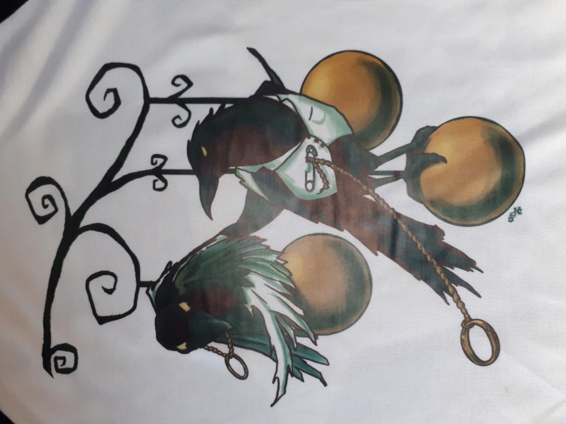

Hi, I have now managed to get all seams outside the press or at least lower than the area to be printed so success?! No, sadly not, I have now replaced my problems with more problems.
In the attached pictures, the black has turned brown in a particular area so I reduced the pressure a bit and the time by a bit but it appears worse. I thought the black might have been burning but not sure now.
I am pressing at 200° for around 60 seconds and the pressure is set manually but I reckon it is high pressure.
Any ideas what I can try next, I have some test material and a few of these shirts I have ruined to experiment with but wanted some advice before pulling my hair out.
Thanks for your help

Re: Pressing issues with clothing
Could it maybe be the material of the garment, I'm no expert, might be worth a wee look into though?[emoji848]
Sent from my SM-N960F using Tapatalk
I wouldn't say so as this is sold as a sublimation shirt from xpres and I have used them before without any problems.
I wonder if I need to adjust my press settings or maybe my colour profile?
Which xpres garments is it, i use them as well, the subli plus t-shirts.
I do them at 200° 50 secs as it says on the instructions from the site, i have a manual press for adjusting pressure as well, so I just tighten it down until around about hand tight, but not to tight.
I find if I do any more than 50 secs and any tighter than hand tight, it starts to brown the garment/burn it a little.
