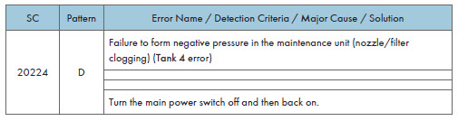

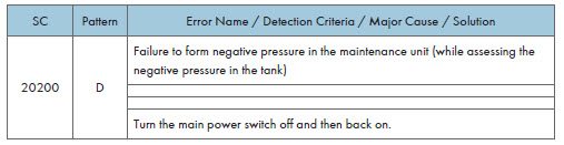

Re: Ricoh 20224 error
[ATTACH=CONFIG]5911[/ATTACH]
[ATTACH=CONFIG]5912[/ATTACH]
These are the error codes in the Ricoh Service Manual. Not very descriptive, so make of them what you will!
Are the carts seated properly, and have the ventilation plugs been removed?

webtrekker;140025 wrote:[ATTACH=CONFIG]5911[/ATTACH]
HI there, thanks for the reply and your help, yes plugs on the carts have one hole free so yes they can breath ok and are seated properly. I have done the head cleans etc so i've now turned the printer off, i wlll check it again in a bit but so far after every reboot im getting the same thing.
