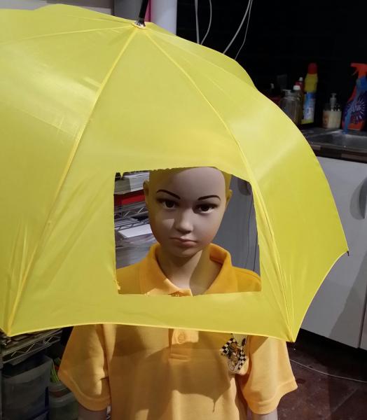

Can anyone tell me the correct temperature, pressing duration and pressure to sublimate umbrellas? 100% polyester. The brollies are from Xpres/Ralawise.
Angie got it wrong first time:
vB_ID:5511
vB_ID:5511
WhatsApp Image 2018-11-13 at 19.36.37.jpg (29.88 KiB) Not viewed yet

:biggrin::biggrin::biggrin: The look on his/her/its face! ".......really?"

I think the problem occured because of confusion between 350 - fahrenheit or celsius - choosing 350degC was the wrong choice!!!!
350F at 60 secs works :) 350C at 60 secs doesn't!

Thats one hell of a heat press you have John. 350c?, you can cook your pizzas on that.

I wasn't there Earl and I darn't comment!! :) :) :)

I think we got it right with 180c for 60 secs.
