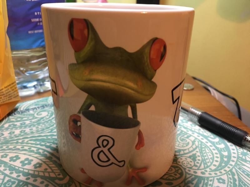

Just to let you all know finally all is working how it’s should with all of your help sonone day we will have cold bear lol
vB_ID:5471
vB_ID:5471
vB_ID:5471
vB_ID:5471
so there they are light not good and still need to learn a lot about it all how to place and all of that but getting there .
