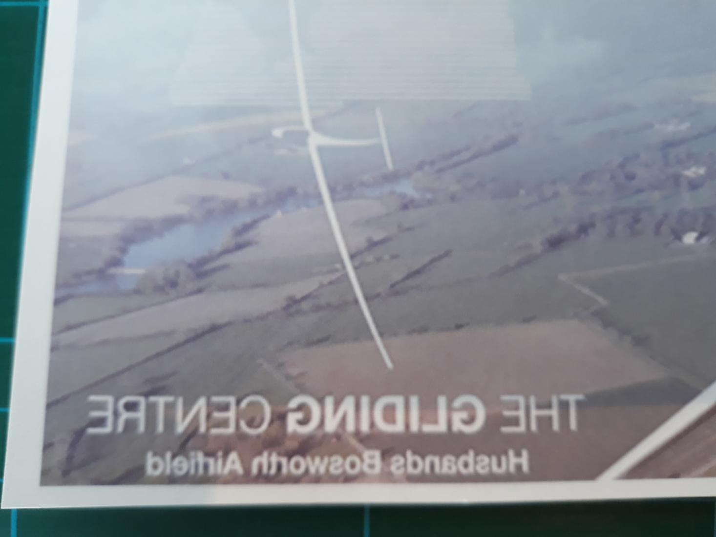

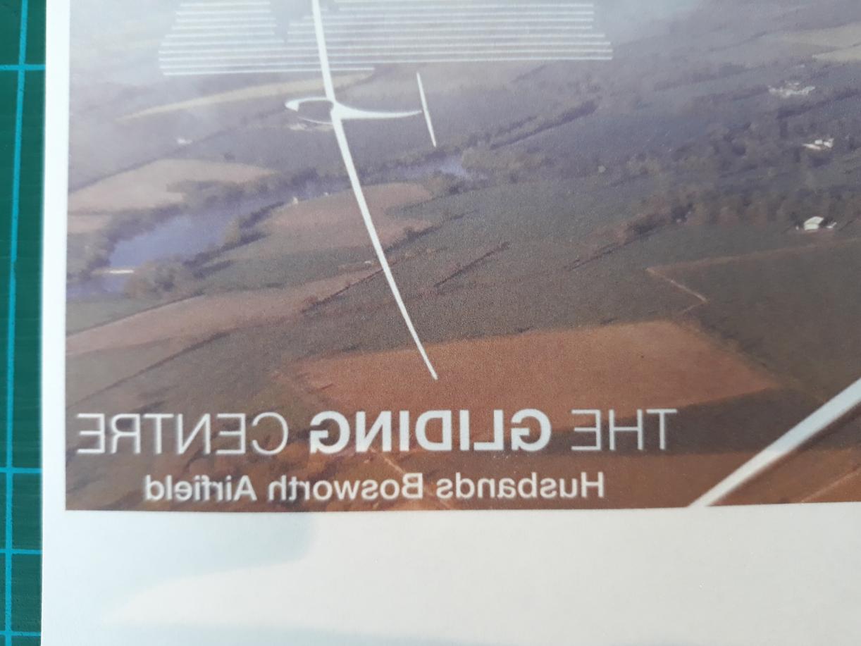

Hi, I spent a long while getting to grips with installing my ICC profile and also learning the basics of Photoshop. Although I can see a slight improvement in the colours produced, Any text on the item is now slightly blurred and not as sharp as the text when I was just using windows publisher to produce print outs. The 2 photographs to show the difference in text clarity. Is there any adjustment on photoshop that I can make to improve the sharpness of text ?

[LEFT]I have also just noticed that when looking at the design as it sits in photoshop even looks poor quality when compared side by side to the design when its sitting in publisher. Why would this be ?[/LEFT]

Ensure your artwork is set to 300DPI, if the image is from off the internet it is most likely at 72DPI (screen resolution) and is not ideal, but can be used as long as the resolution is increased.
Programs like Publisher will only show an image as screen resolution so it will look decent, when opened in Photoshop or other more advanced pieces of software the image issues will be shown more clearly.
You can easily change the DPI by selecting IMAGE> IMAGE SIZE > RESOLUTION : change to 300 (pixels per inch)

Re: Ongoing ICC profile & Photoshop issues, Help please?
Can I just say, increasing the resolution of a 72dpi image to 300dpi will not improve the image. It may improve slightly, due to Photoshop's scaling algorithms, but may appear with jagged or blurred edges. The best thing to do is to start off with an image of 200 to 300 dpi at roughly the size needed.
For simple, non-photographic images, it's sometimes possible to vectorise a small image then upscale it to the size you require to achieve a better result.

Thanks for your help & suggestions. I do realise that sub printouts look different on paper to the finished pressed article. I thought I had said that the difference was as apparent on the pressed item, as i had printed & pressed a few trying diferent settings. My main issue was that Photo shop was reoprodicing exactly the same immage poorer than publisher was, and this apprently in both the paper print, and the pressed item (mug) It was the text that was poorer, not as sharp. But the colours were fine, better in fact with photoshop. CP
