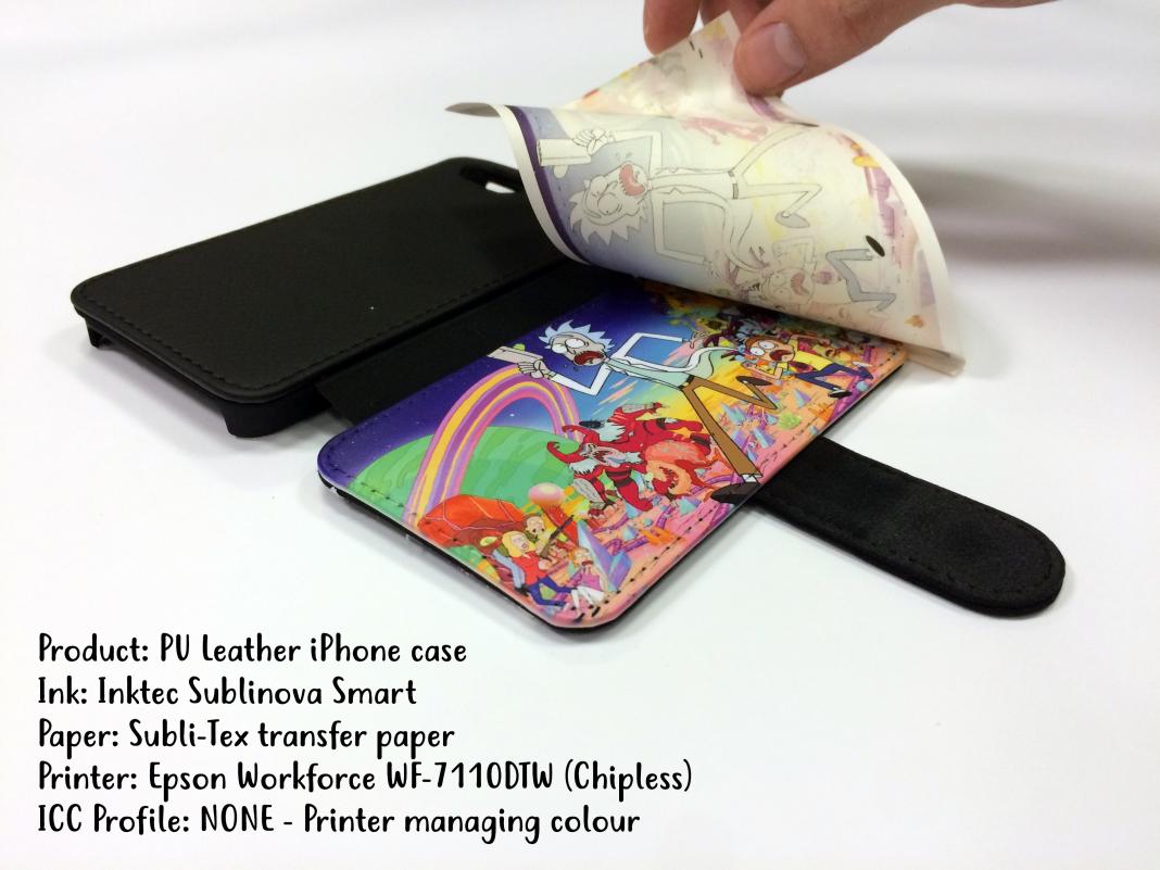

Not sure why the WF7110 gets so much hate, with the right inks and ICC profile they work brilliantly
research is key with any printer.
- vB_ID:5200
- WF7110_sub_test_8.jpg (89.39 KiB) Viewed 345 times
