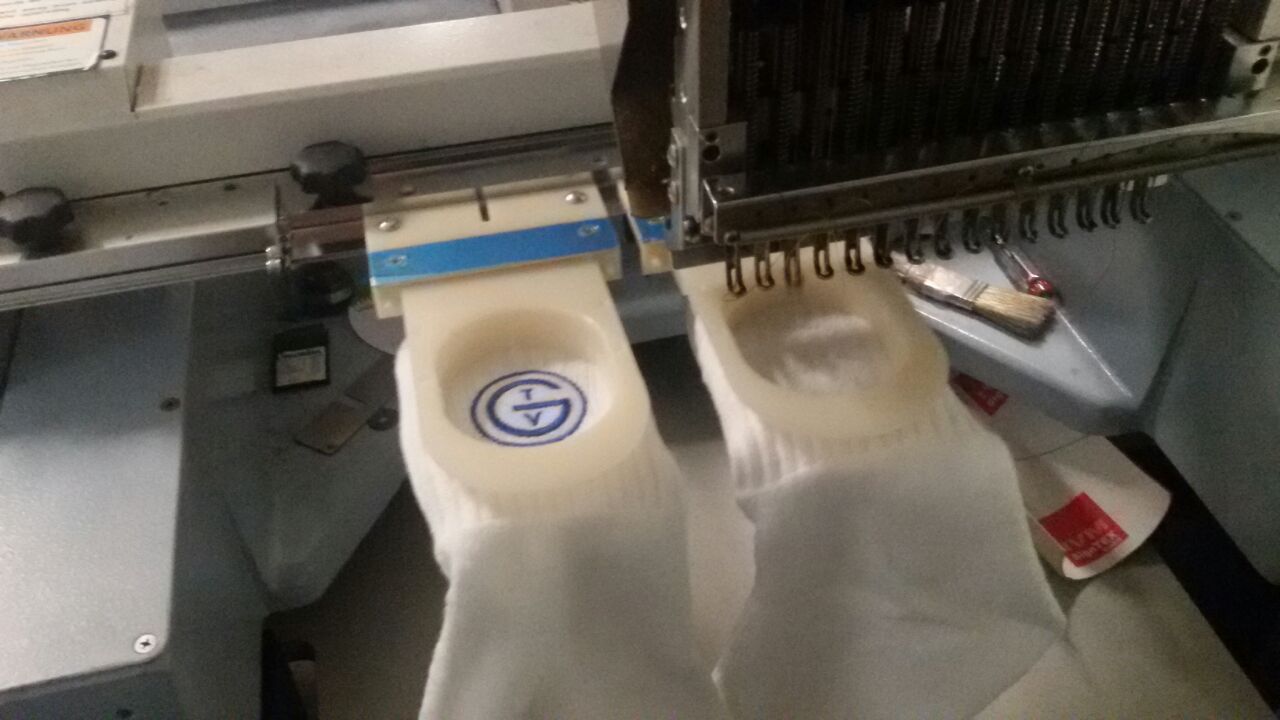

He is a photo of the socks in the sock attachment on the machine. The left sock is only there to show you the finished embroidery.
This sock attachment cost around 300€ so I only have one.
The job is going slowly. I can embroider 15 pairs a day. 250 pairs will take some time but should be done by xmas.
