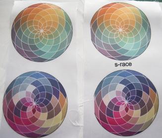

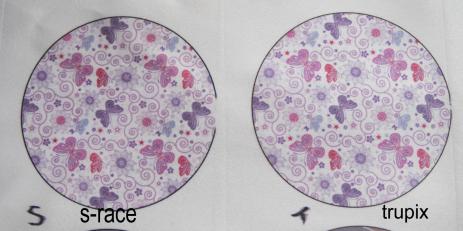

Re: S-Race Sublimation Paper - A call for reviewers!
Thank you for the sample paper.
I printed some samples on polyester and compared to Trupix. Samples are about 85mm in diameter.
Sawgrass ink in Ricoh GXe7700, pressed at 190C for 50 secs.
My initial impression was that the s-race prints were more vivid. On closer inspection I think that the bleed, though minimal on both samples, was less on the s-race print. This made the edges of the colours sharper and the butterflies in the second picture have more wing definition.
Photos are attached.
Like others have commented, the mug paper is too small for my prints as well. I usually cut a4 into 2 lengthwise. However, will try with paper on some ceramic when I'm next testing a new design.
Thanks again,
Skye
Thanks again,
Skye
