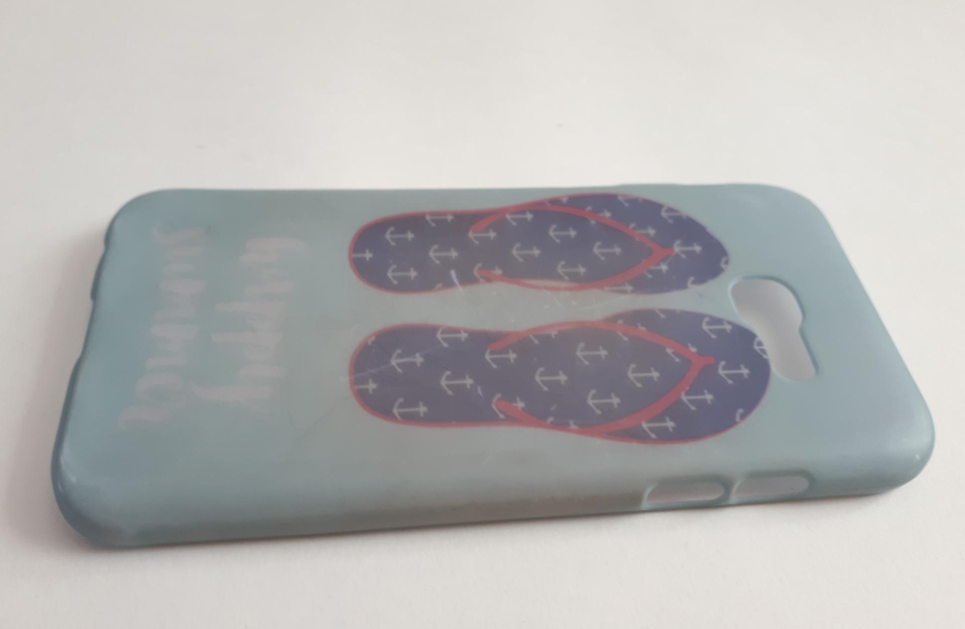

(I fhave attached picture, how case looks)
After two month regular use matt case looks like this (little scratches in corners and middle of case).
Is it regular?
Or is it disadvatge of matt case (glossy dont have such problem atleast not in such short period)?
Is it regular?

I think the scratches has something to do with the case itself, not the ink or press. I never experienced any such problem with matte cases, I just took one I have and tried to make scratches to it as hard as I could, to no avail (Sunfly PolySkin).
