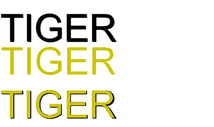

You could add a drop shadow to the text and cut that in black, then cut the text in gold and put it on top of the black.[ATTACH=CONFIG]4548[/ATTACH]
- vB_ID:4548
- TIGER DROP.jpg (36.41 KiB) Viewed 221 times
Re: Gold prints
That is how to do it but my client did want a double layer of vinyl.gorgall2;121846 wrote:You could add a drop shadow to the text and cut that in black, then cut the text in gold and put it on top of the black.[ATTACH=CONFIG]4548[/ATTACH]
