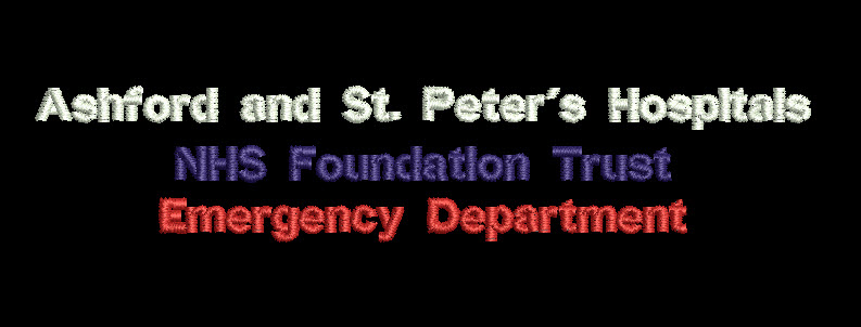

[FONT=&amp]Good morning all from a very grey Wales![/FONT]
[FONT=&amp]
[/FONT]
[FONT=&amp]I would appreciate some help/advice with a problem confronting me.[/FONT]
[FONT=&amp]
[/FONT]
[FONT=&amp]I'be been asked to embroider some fleece jackets with embroidered text only on the left breast. The customer has requested 3 lines of text, the first line being:[/FONT]
[FONT=&amp]
[/FONT]
[FONT=&amp]Ashford and St. Peter's Hospitals[/FONT]
[FONT=&amp]
[/FONT]
[FONT=&amp]This is the longest of the 3 lines of text and if I choose to use Wilcom Block 2 font at 5mm height the embroidered line would be over 12cms long! This seems too long and might not work on the smaller jacket sizes.[/FONT]
[FONT=&amp]
[/FONT]
[FONT=&amp]How would you deal with this?[/FONT]
[FONT=&amp]Would you use a different font, if so which one?[/FONT]
[FONT=&amp]Any other advice?[/FONT]
[FONT=&amp]
[/FONT]
[FONT=&amp]Looking forward to any tips :)[/FONT]
[FONT=&amp]
[/FONT]
[FONT=&amp]Thanks[/FONT]
[FONT=&amp]
[/FONT]
[FONT=&amp]John[/FONT]

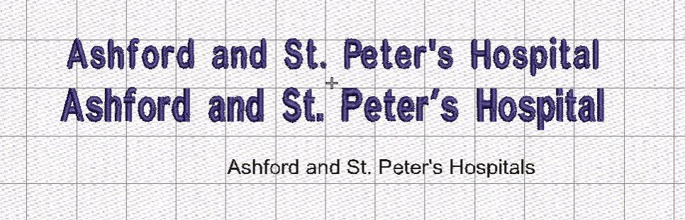

Hi John,
Ive Used Block 2Auto for the bottom one and Arial Rounded for the top. Both have the collumn width reduced by 10% or -10. Find that tool under the Pull compensation tab.
Height is 8mm. 11 and 10 cm long. I dont see a problem. Also narrow the understitch (zigzag) down so it doesnt show when stitching or use center line.
Hope this helps.
Edit. Also you can increase the density down to 32 and use the 60 thread if nessesary. This is useful if its really fine work but I wouldnt for this text as normal density is ok.
