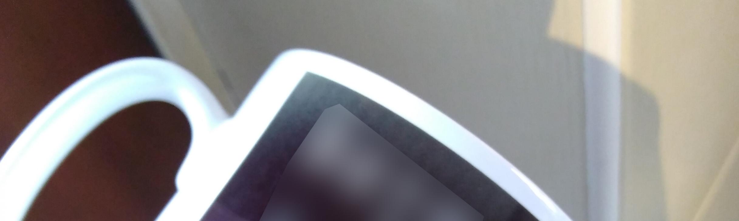

I am currently pressing at 185 degrees for 80 seconds with an idle temperature of 160. Quite hard to get a decent photo but this one demonstrates my issue, seems to be the bottom corners nearest the handles that suffer most but it is happening along the whole bottom edge.

You are not getting enough heat into the base. As there is more ceramic in this area it is like a sink hole and heat keeps absorbing until the whole base is upto temp. During this time the body has already started printing. Various ways to overcome this and many discussions on here. Basically you need more heat but not too much to scorch the body. Warming the base prior to going in the press is always first course of action especially with the orca which tends to have a heavier base to keep them straight. Try sitting the mug on a radiator for a minute or you can even sit them on an upside down mug that has just come out of the press. Try printing one after that otherwise then you need to move on to a combo of more time/temp scenario. The corners fading might also need a bit more pressure on the press. Elements soften after a bit so will naturally shape to the mug better but a new press can be firm.
