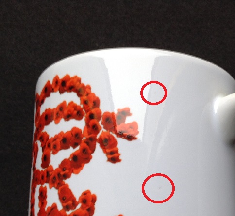

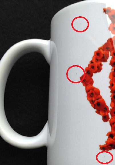

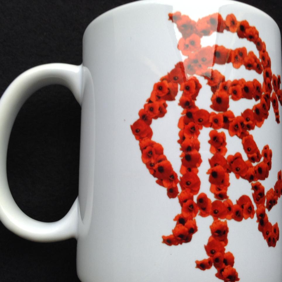

So I took the shadow out of the SoConnect image and printed and pressed and no specs, so the shadowing from original image is the problem and its the very edge of the shadow, but the weird thing is when I looked at other mugs I pressed, the specs where not all in the same location as the ones pictured, they were still on the very bottom of the shadow around the edge, just in different locations
Phoenix
Posts: 14
Joined: 28 Nov 2016, 17:23
Re: Several issues Ricoh 3110DN
Post by Phoenix »

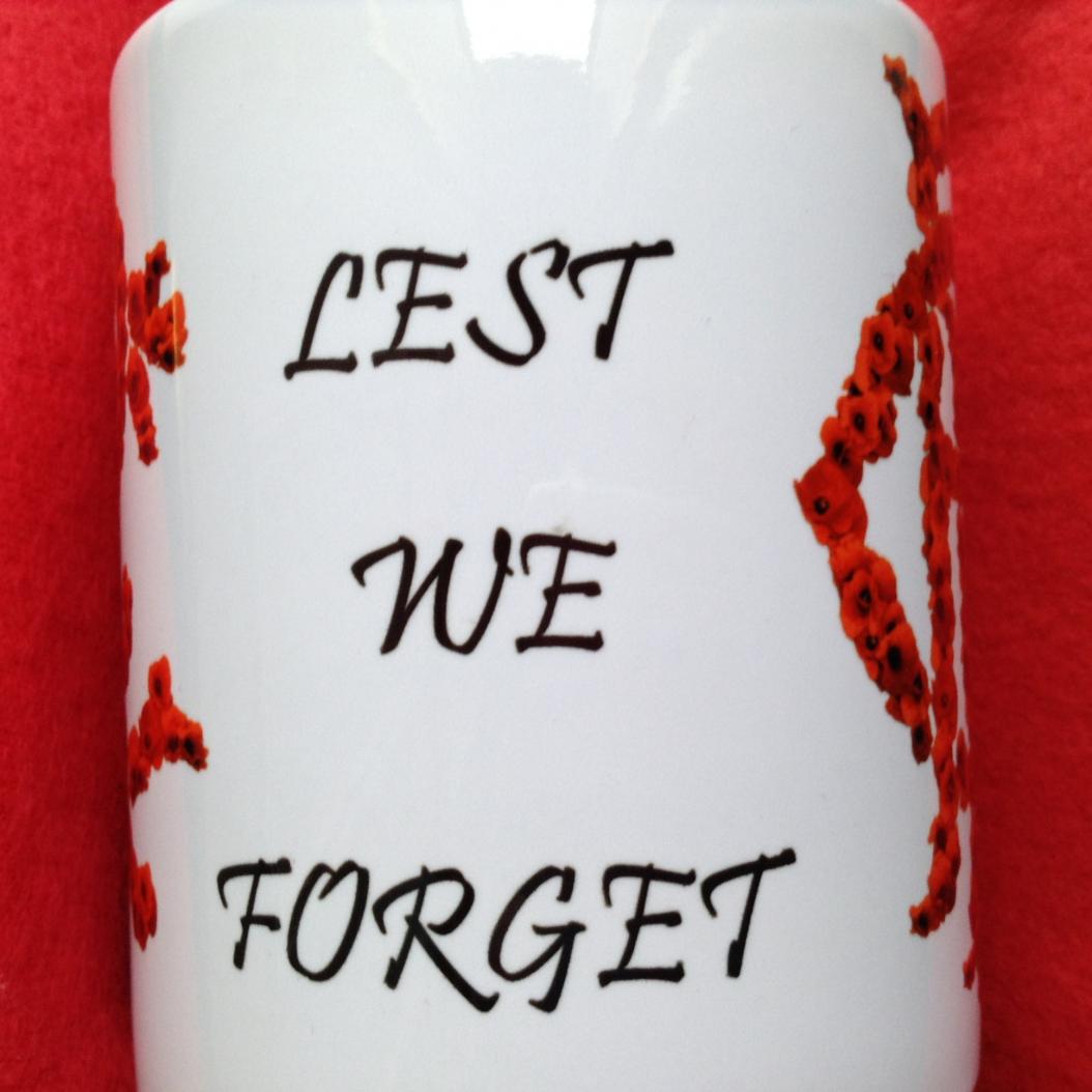

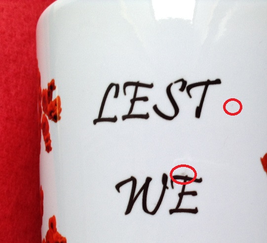

So done another mug and more specs have appeared and a little bit of bleed from the text, all background data was erased for the image, mug was clean, heating element was cleaned and they still appear, any other ideas before changing paper and inks?
