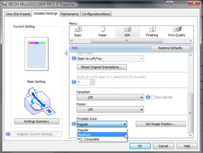

Is the 7100 like the 3110?
My 3110 printer driver allows a slight increase in page area by setting to Maximum ...

Re: A3+ on 7100?
That's interesting. I shall go and get a minion to check. Although with the smell of coffee in the air they are probably all on a break so better go do it myself!
Re: A3+ on 7100?
Well I got someone to change this setting and aside from the new item, we are now printing 12 coasters per A3 rather than 8 so that saves A LOT of paper. Have a virtual coffee on us!
