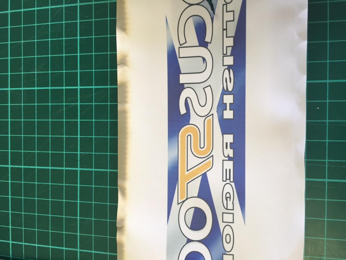

I have a problem with the edge of my paper burning when sublimating a mug. This has only started today.

Mug Paper.jpg (81.42 KiB) Viewed 3 times
Adkins Studio mug press
Sawgrass Ink
Texprint mug paper
Time: 140 sec
Temp: 180
Keith

This happens with us all the time and doesn't effect the sublimation. Either guillotine the paper so this doesn't over hang the ends of the mug or perhaps take a temperature reading of the blanket in case it is hotter than the setting tells you.

yep trim the paper (you will get more mugs per page as a result as well)

Thanks for the replies. I will trim the next one. Quite strange tho how it suddenly just started after a while.

I tend to print 160c 160 secs with my inks. Certainly Ricoh inks will print at a lower temp.
