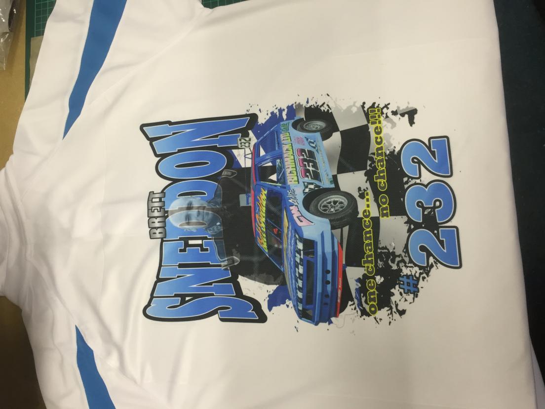

I have a design for the rear of a polo shirt just now which I sublimate (see pic). I want to put this on dark polo's and hoodies.

Yep, with that image you will need the 711W. Hope you find someone in the UK who can help you.
