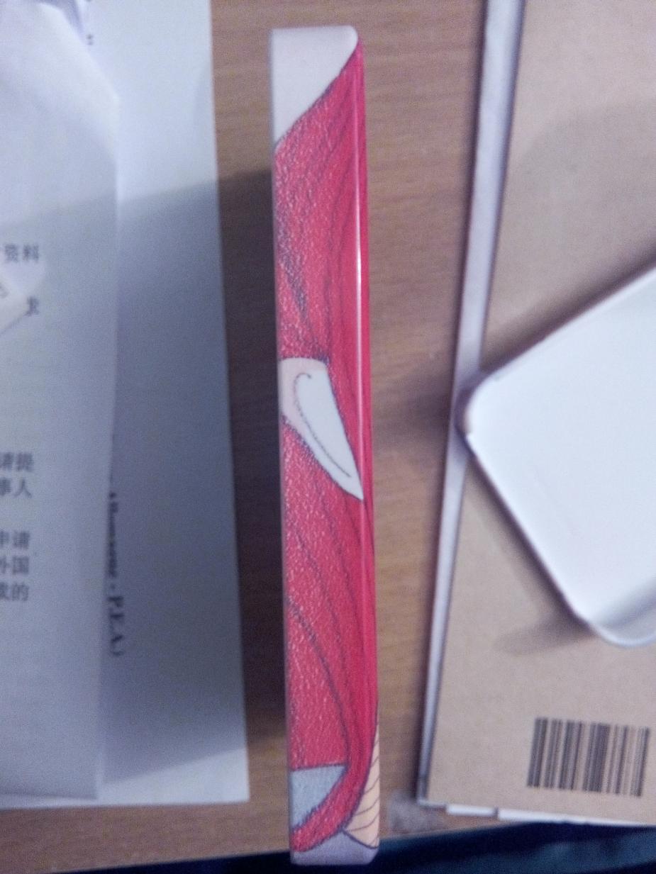

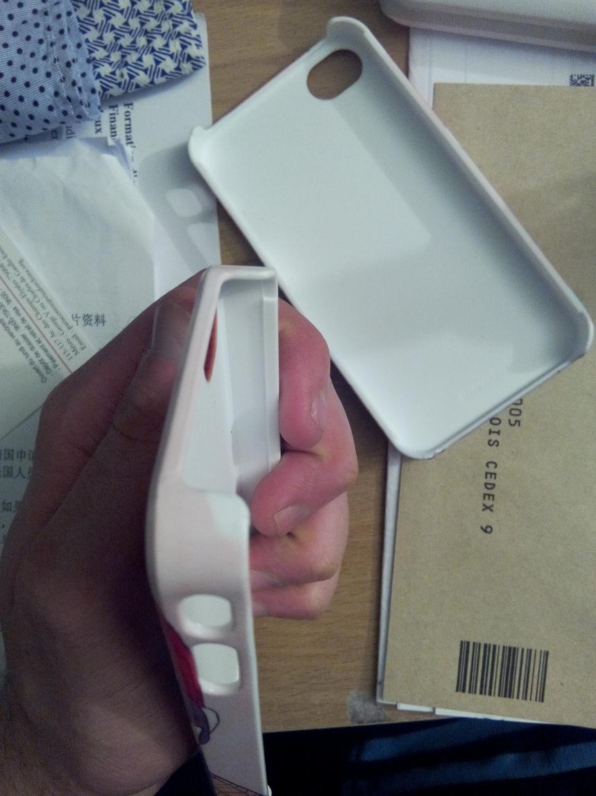

Hello everyone, I recently bought some transparent 3D film for my ST-2030 3D vacuum machine. I thought I would avoid hassles with it but it's the opposite.. I have unconsistent results, each case come out either blurry on the sides and/or with corners not fully transferred. I already wasted like 20 blanks/films. Any idea/advice ? Thanks !
Settings: 360S @ 140°C (25S vacuum delay, 90°C preheating)

Would cook them hotter. 160

Wouldn't the film crack at that heat ?
