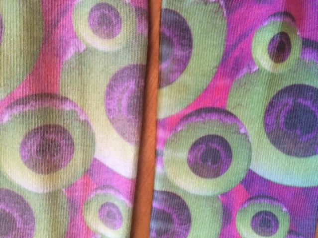

Hi all. just started using our sawgrass sg800 and have a very odd problem. Our colours looked a bit washed out/faded but something even odder happened when i did a quick test hand wash of one of our socks. There was colour loss from the wash and it's visibly more faded than the non-washed sock (tried to take a photo but my camera wont pick it up).

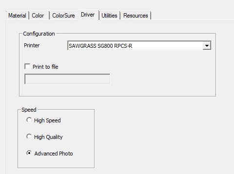

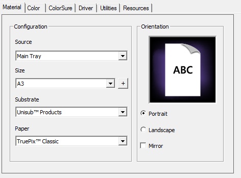

screenshots as follows showing our power driver settings:
vB_ID:3931
vB_ID:3931
setup b.jpg (24.6 KiB) Viewed 1 time
vB_ID:3931
vB_ID:3931

vB_ID:3930
vB_ID:3930
setup a.jpg (34.29 KiB) Viewed 1 time

I've attached as good a photo as i can get of the washing out. Its more noticeable in real life...

Just emailed the sock supplier (BMS printer owners) and they confirm they are polyester.
socks are not especially ribbed when compared to nike elites or similar.
