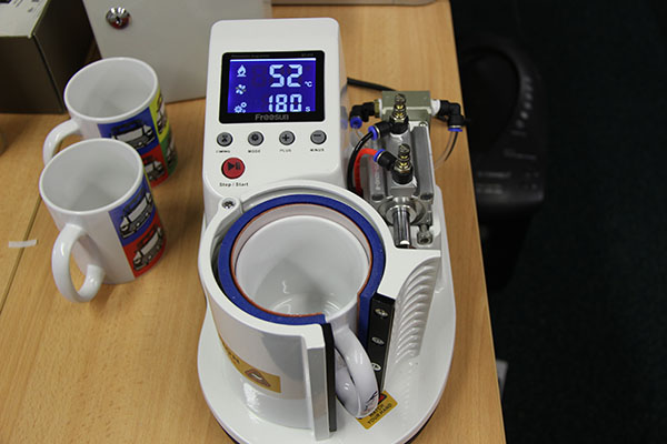

We've bought one of these to trial. I really want to find something that will give us full coverage mugs painlessly.
We have pre-heated bases but they give us soft top corners. Constantly.

Ours works great for white background designs.

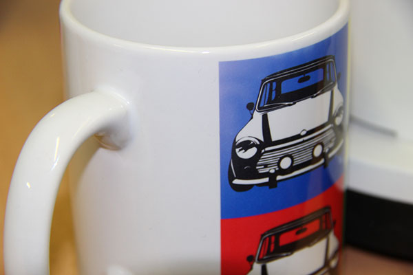

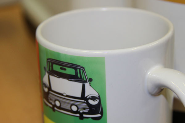

I pre-heated the base of the mug for 30 seconds before applying a full coverage design. The bottom came out perfectly but the top corners were still soft. I tried lots of different temperatures, right up to 190C for 220 seconds. The corner was still soft and there was browning on the front of the mug. I couldn't produce anything salable with a full coverage design.

Oh and it's a BestSub ST-110.
