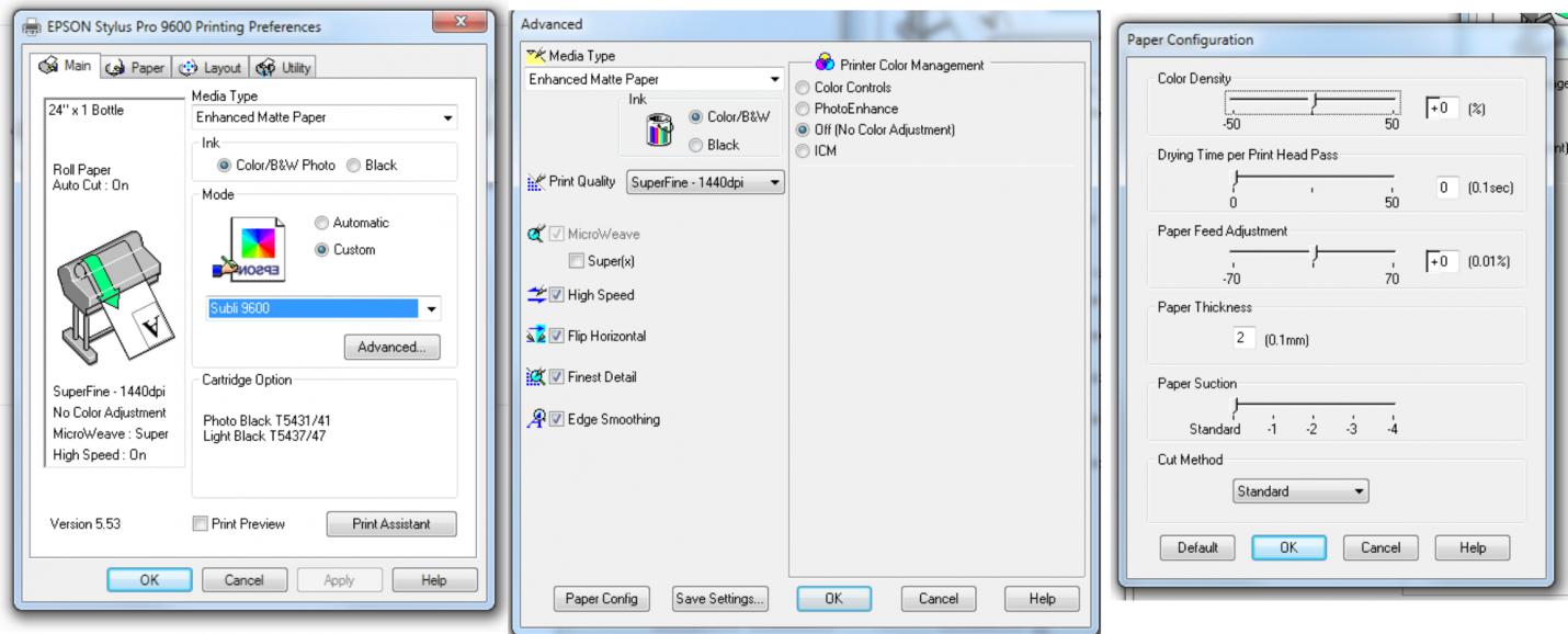

Many thanks Tim. Installed this driver and working fine. I've created a profile using my Color-Munki whilst I await a response from (busy) Paul :-) This appears to be working well and prints are comparable to my Ricoh 7100, colours a little softer.
I'm not 100% sure on driver settings and have opted as shown below. Finest detail made a difference to the edges becoming more crisp so I've left that on, not sure if edge smoothing will help further? Should microweave/Superx be on?
I've only just seen the paper config screen so have left this alone unless you can offer any more suitable alternative settings?

I've read that superx tells the printer to make 8 passes instead of the usual 4 to eleviate banding, this would explain the huge speed difference :- .
Re: Epson 9600 - Initial install advice
for hard substrates, we have the same as you on the print settings, except superx on, and high speed off - the print speed is slow but great quality, so we print in bulk and store transfers - this works for us as our designs are set and not one offs/personalised. With 100m rolls of paper, and great reliability, the printer just keeps rolling 24/7 when needed.

Great, many thanks. Prints are looking really good even with this profile I made myself.
