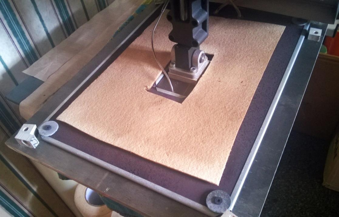

this is the existing element .... anyone know where they may be available from ?
surely a replacement element has to be far cheaper than £280 for a full platen replacement. The existing platen is mint condition ..

Unless they've changed things, you should be able to buy just the element from PressMech, but that said, from the look of the photo, the element does look bigger than the ones in our presses (older models.) We've had two elements go over the years in these, but we run them for hours at 220 degrees, which is higher than most work these are designed for, and one failed mainly due to being in a house with dodgy electrics which tripped out all the time, so that added a lot more stress to the element.
The element may well be a standard part (like the plastic control box enclosure, and the timer and temperature controllers), or it may be custom made for PressMech. If it's the former then you may be able to source one much cheaper, but good luck tracking them down - I did try, but most searches I've done just bring up elements for domestic ovens!
