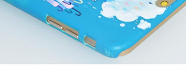

Just been looking at the sunmeta website at the page for the new small & cheap film machine. One of the cases they display doesn't look like it's printed that well. The blue one, have a look at this screenshot from their site, the corner of the case looks pretty bad:
vB_ID:3442
vB_ID:3442
vB_ID:3442
vB_ID:3442
So if they did this case in that machine it's not very promising...
