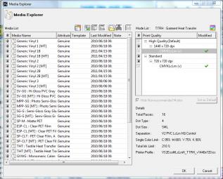

Either of these help?
vB_ID:3401
vB_ID:3401

Not sure the res of your image is too low to read I can see that you use the default of Pre-press US where as I tend to use Max Impact.
