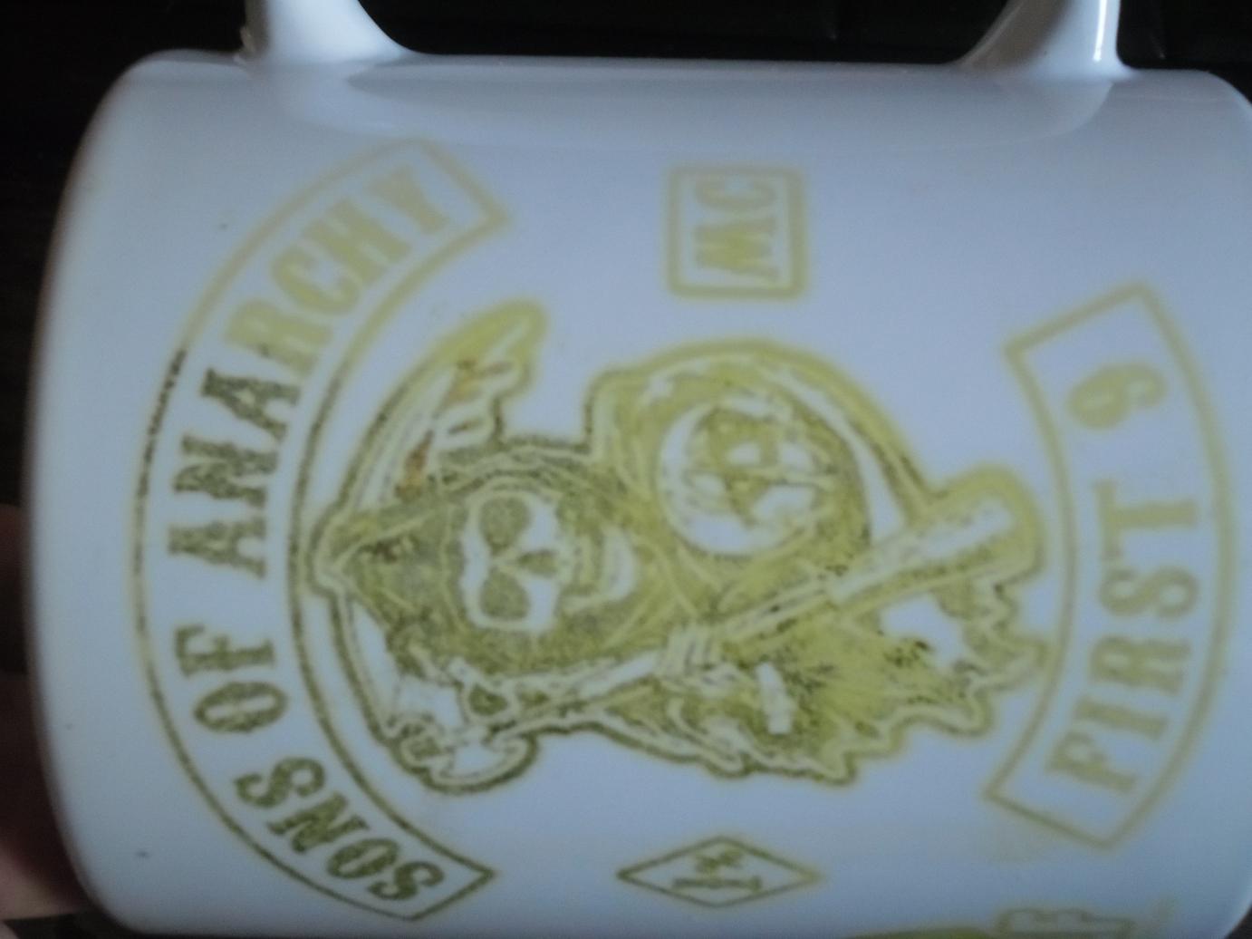

I have the same issue I started doing this about 2 months ago and after issue upon issue I'm at the stage where black comes off as brown now. I was getting the yellow for a long time. Trying to increase and decrease my temp and time. I spent a lot of time on google trying to self evaluate once I contacted my suppliers they could see what I was doing they recommended 190 c for 150 seconds which gave what is pictured below. (blues greens browns etc)
vB_ID:3863
vB_ID:3863
The ink suppliers have been very helpful with my issues asking for pictures when doing things particular ways for them. They have came back to me saying its either my cups, the ink (which they sold me for the purpose im using it for) or the paper I am printing on.
Paper and cups came as a package deal with no information on my paper which the ink suppliers have been sent samples of. Right now I am sitting with a Ricoh SG2100n as well having bought refillable cartridges from a company on ebay and have put sublimation ink which the supplier claims are specially made for sublimation and heat press images for the Ricoh 2100, currently going through google to see about ICC's or at least the settings for coral before continuing on, and now that I've rambled on I shall continue the search.
I was being told by someone else who does sublimation that the best way to check your ink is an old white t-shirt, print an image off and press it onto it. If the images comes off good then your ink is right.
To anyone reading this in the coming months - talk to your suppliers, they are more than happy to help, because if they get you running they get more business overall! search engines have alot of answers but if your new to sublimation it's okay to be annoying.

Hummmmm really looks like not sublimation ink, more like ordinary domestic ink jet ink.

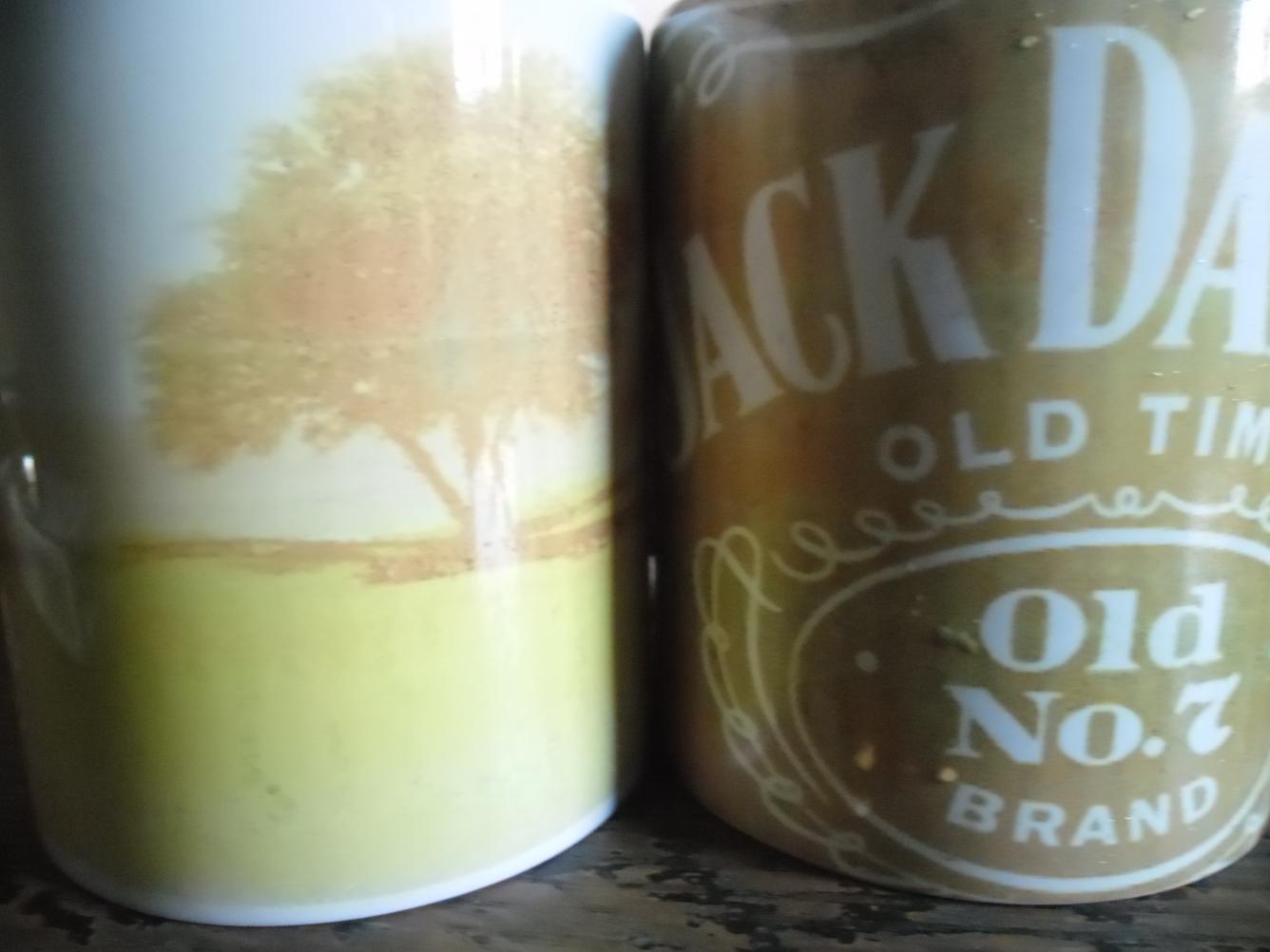

ArferMo -
I am thinking the same on the ink side of things, but I'm trusting the experts and taking there word for it until they say its not the right ink so I can slap them for sending me the wrong stuff :P
I was all too happy the other day to get those cups like that... I have about 70 sitting in the house that all look like this.
