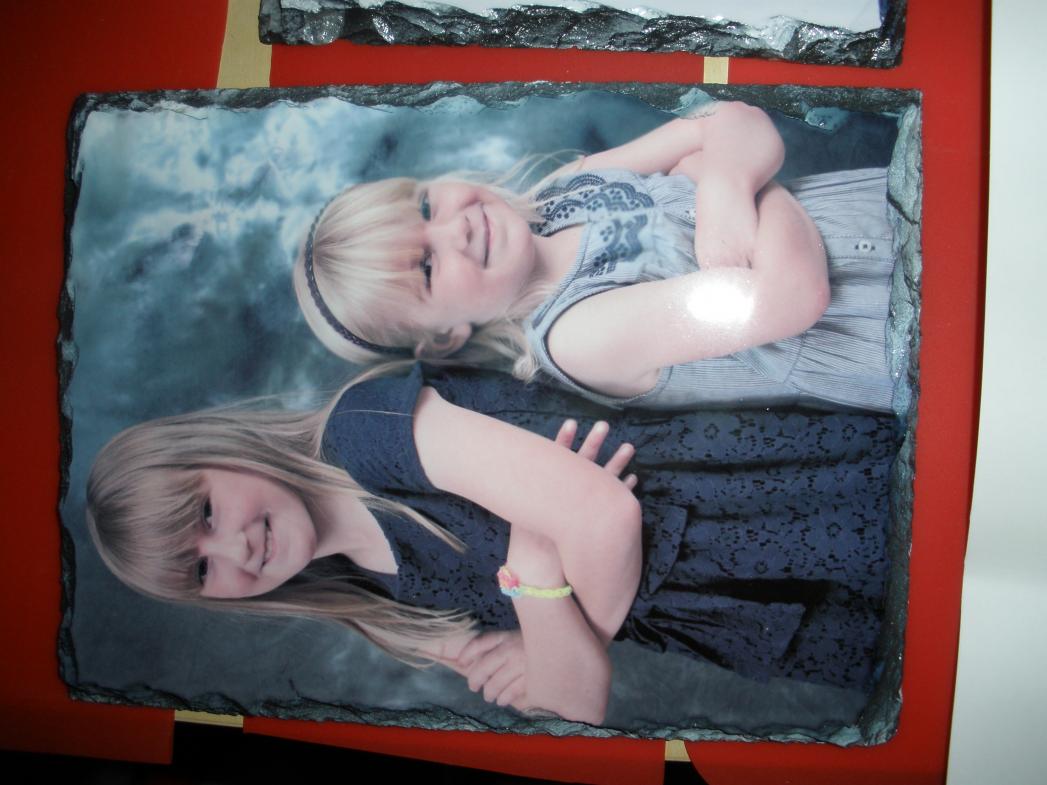

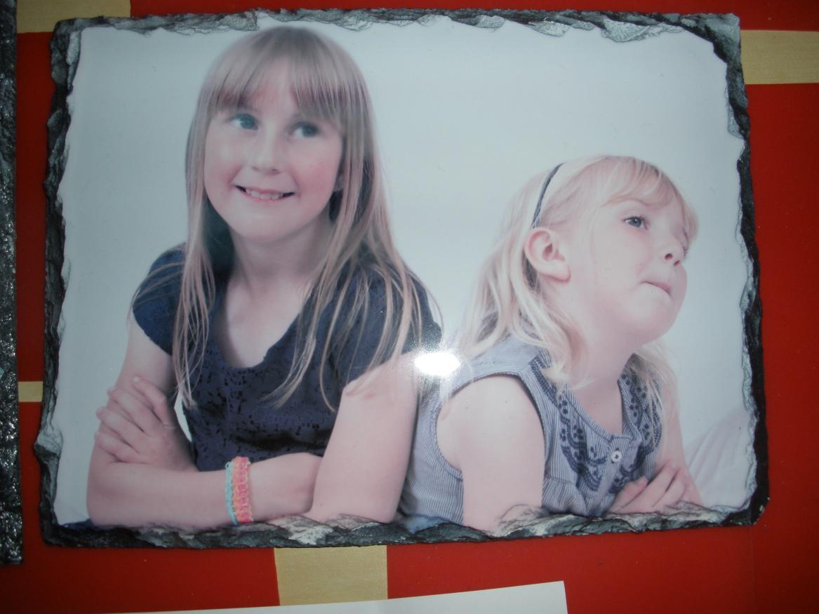

I seem to take one step forward and one step back with the printing of slates. I do a couple, following Paul's tried and trusted method and everything seems fine. Then I do a couple more, same method and the print is poor. Light colours etc and a strange circular mark which seems to be coming from the plate of the press. I've altered the pressure of the press so that I can put a sheet of greaseproof paper in between the slate and the press and only remove it by a light tug, there is some resistance.
Using this method I produced a lovely print and I'd also used a temperature of 190C which I saw that Paul had used recently. Great stuff, I thought, do another with a light background and the print just isn't sharp and there seems to be some banding after the print. I just can't get this consistently right regardless of what I'm doing.
Any ideas anyoner, Paul maybe. Yours always look so good. I will try to post some pics tomorrow

I am use paper on top of the slates now. I used to use a silicon sheet, but wasn't getting good results. With these 2 pics I test the pressure by whether I can pull the paper from the press. If I can't move it I lighten the pressure until I can take the paper out with a light tug.
vB_ID:3058
vB_ID:3058
vB_ID:3058
vB_ID:3058
The second lighter background picture is not as sharp on the slate as it is in reality. It is around the eyes of the older child mostly. It's so frustrating as I end up wasting slates.
Thanks for the input. I may try even lighter pressure.
