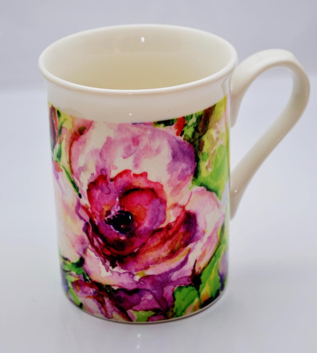

That is why I went down the oven route. I have only had failure due to human error. I leave it at 200 and cook for 18 mins for all mugs and styles. I even done some china cups the other day and was a bit worried about my settings but they came out great.[ATTACH=CONFIG]2795[/ATTACH]bycandlelight27;88894 wrote: I've read lots of posts and some say pressure, some say heat and some say time
Good luck with your new press.

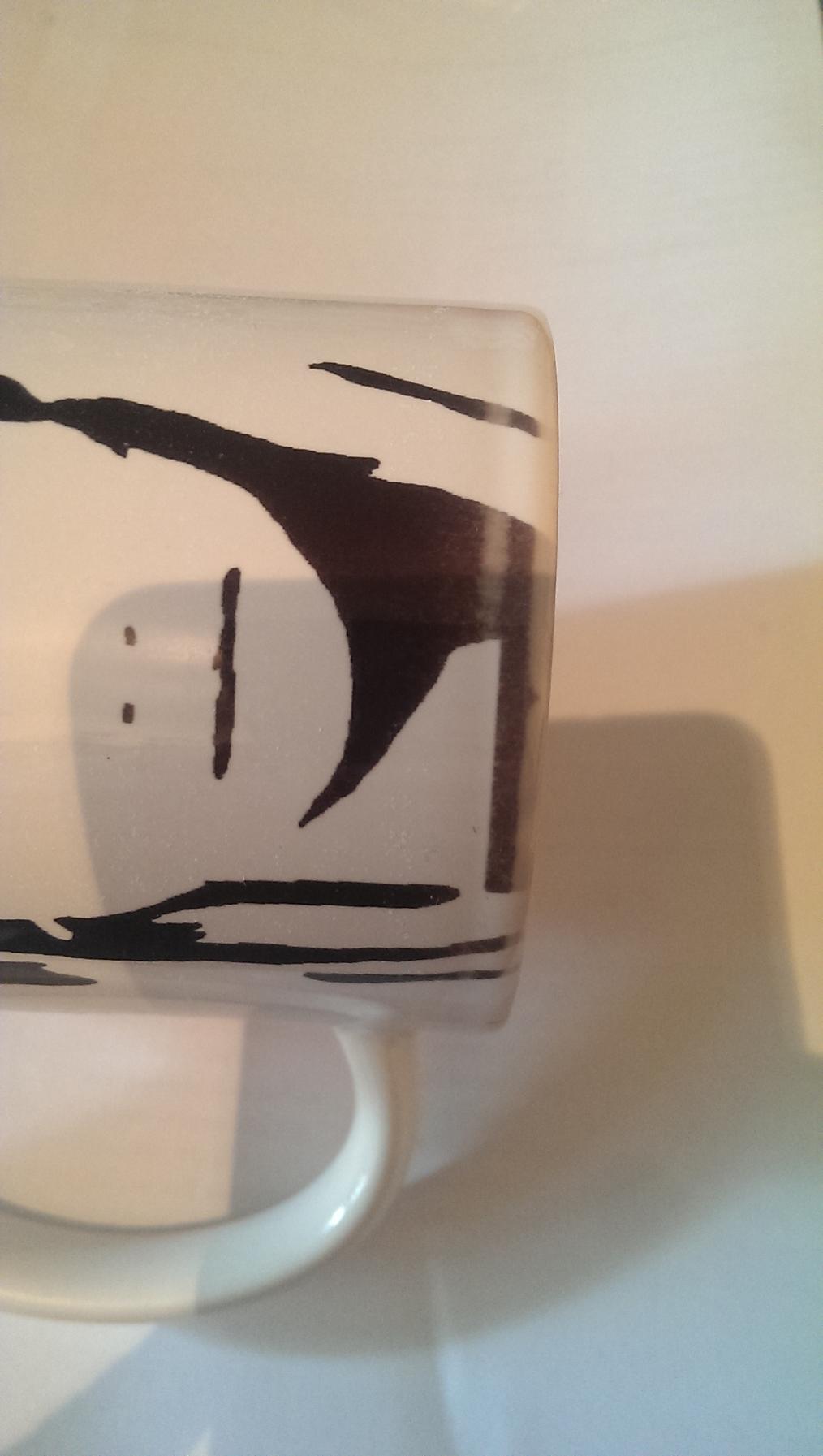

[ATTACH=CONFIG]2796[/ATTACH]
Here we go, basically the bottom cm.

Not sure if you mentioned it but whose mugs are you using? As mentioned, heating the bottom for 30 secs or so can make all the difference but not always necessary with good quality mugs.
Re: switching over from oven to press
I can see a lip on the bottom of the mug, that will be the cause of the problem, it is pushing the blanket away from the mug hence the band. Straighter mugs would solve the problem. A bit tighter may help.
