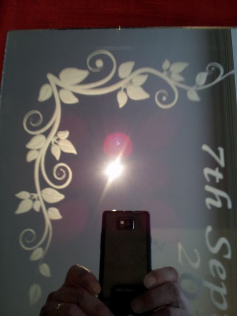

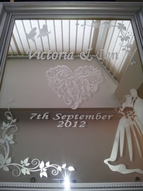

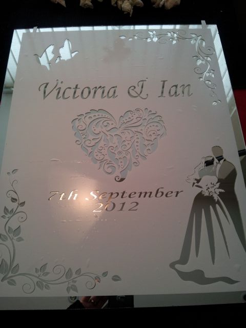

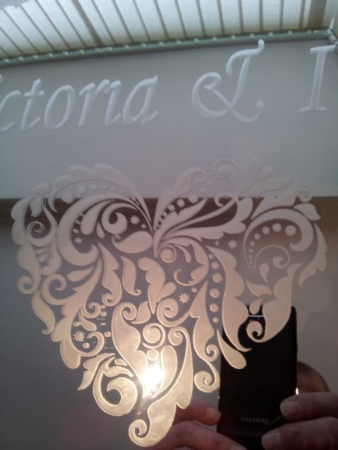

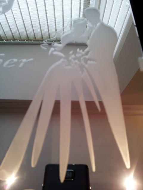

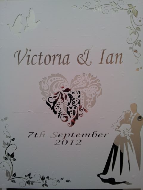

Try ArmorEtch. I use it for doing mirrors. I got a large tub for about £19....it is actually re-useable if you are careful which makes it go a long way!
Heres one of my examples...

They are excellent. I've recently experimented with this but found the stencil difficult to weed. What do you use for stencils?
arko
Posts: 565
Joined: 01 Aug 2012, 21:43
Re: Glass etching
Post by arko »
I used cheap sign vinyl. It was a bit tricky weeding the heart design but as they say..."patience is a virtue!"
