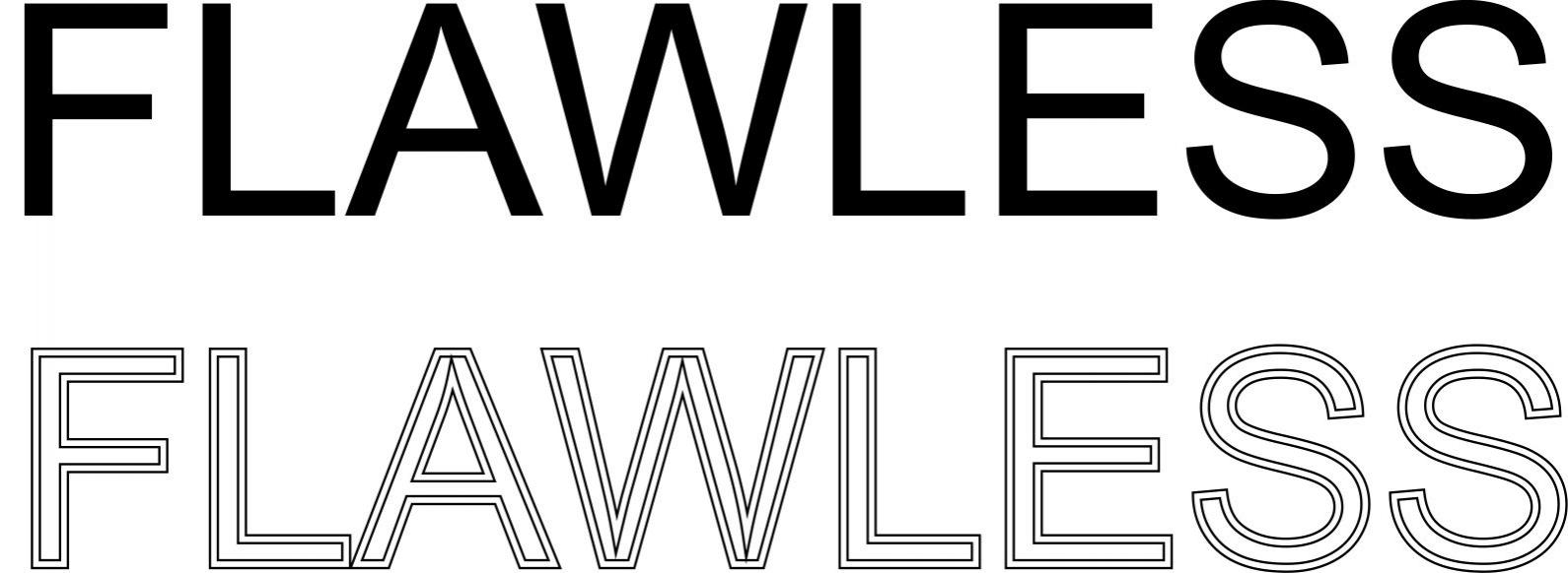

I think what you want to do is this:
Put "Flawless" in as text in the font you want to use.
Add a border that is the size of the distance you want the two lines to be apart.
click arrange>convert outline to object.
You should now have 2 objects - the original text & outline - on top of each other.

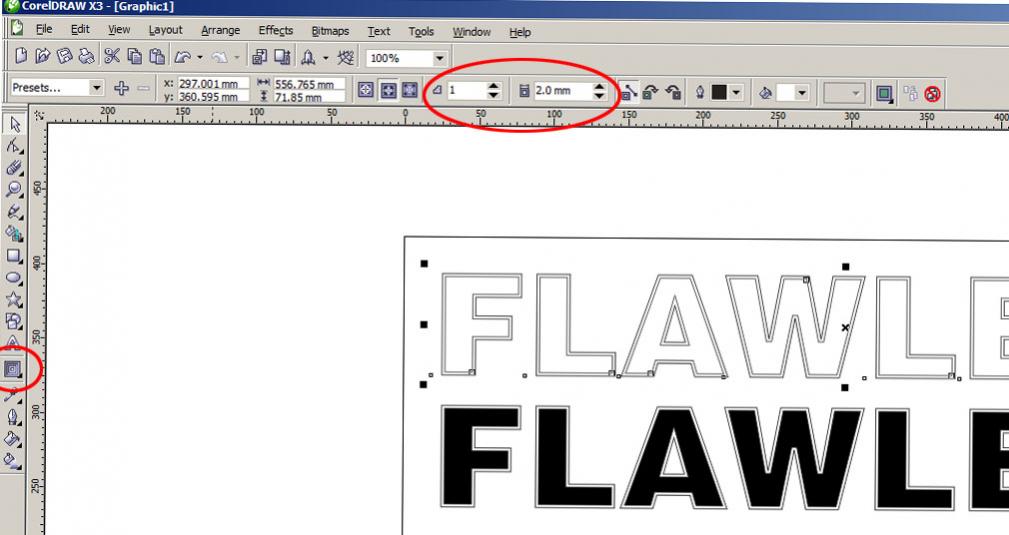

Re: Coreldraw Help Needed :)
Hi Stitch
This is Corel X3 so hopefully it will be the same. The red outline shows the tool you need and also the two bits that control the depth and number of objects to create.
[ATTACH=CONFIG]2616[/ATTACH]

Stitch Up
Posts: 1461
Joined: 01 Oct 2009, 05:00
Post by Stitch Up »
Thanks everyone :)
@socialgiraffe
Corel X6 is a little different. What tool is that called? I'll be able to find it :)
Cheers
John
