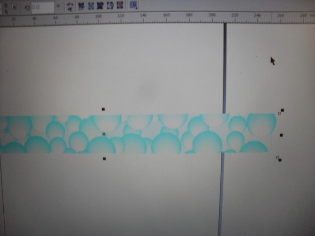

I have teaching myself about blends and transparency and made a bubble design for a ruler for my daughter. It should be a bright turquoise image.[ATTACH=CONFIG]2343[/ATTACH]This a photo of the screen showing a rough idea of the colours. I don't know how show the actual screen shot.

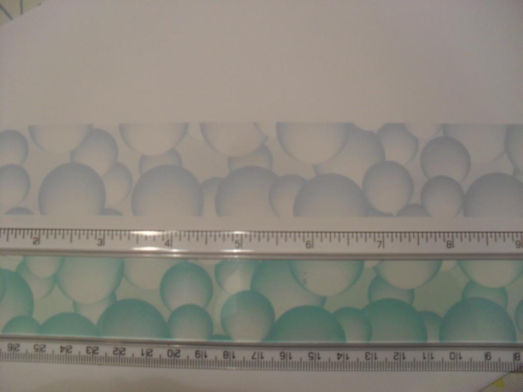

This is what prints (top) and sublimates onto metal insert. ( bottom) .[ATTACH=CONFIG]2342[/ATTACH]
I am sure it will be something to do with the printer not being able to match the colours fully or that the monitor is just brighter and the print is the true colour.

That does seem the most likely.Quinsfan;81824 wrote: I am sure it will be something to do with the printer not being able to match the colours fully or that the monitor is just brighter and the print is the true colour.
You could achieve better reproduction of colours with a printer with more than 4 coloured inks, but also buying your own ICC calibration kit, to profile your monitor (so what you see if more accurate) and your printer, so the colours are truer to what you expect.
There are limitations though, especially with sublimation inks.
We have a 7 colour printer, and our own profiling kit, but there are still some colours that we struggle to hit as much as I'd want to.
I would also recommend that you do some reading up on colour management,and read any help files in Corel about how Corel's colour management works.

Looks like that colour is outside of the colour gamut the Ricoh is capable of hence it is struggling to match what you see on screen.
