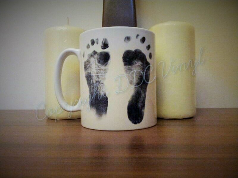

I got mine from ebay.. the only issue is that if you touch the wipe.. then the paper you will get fingerprints appear too.. so you do have to be really careful with them..
I then scan them into my laptop.. crop the images and print
[ATTACH=CONFIG]2303[/ATTACH]
