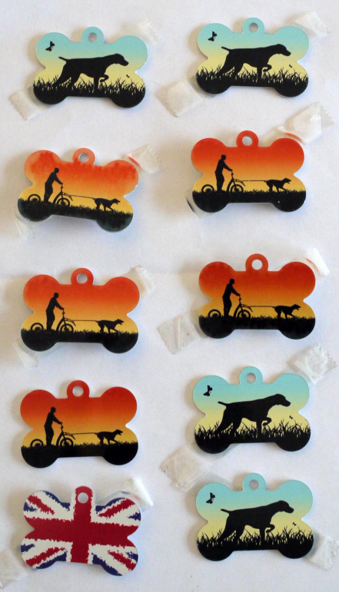

After using the temp gun, and changing the temp on the display to 175C so that the platen was actually at 190C in one spot, I printed a single tag, and it was the best result I'd ever got, the black was actually black instead of mottled brown (from the temp being 15 degrees higher than the display said I presume), but then these 10 tags were all printed at once, and the results vary across all of them, because it's not an even heat
[ATTACH=CONFIG]2247[/ATTACH]
I know my statutory rights and distance selling regulations, but the guy on the phone didn't seem interested, and we can't send anything back after the first 14 days
Now I'm in a tricky spot of having orders to fulfil, I'd need to borrow money to buy a new press (my business isn't making a profit yet), but don't want to borrow if I end up not being able to get my money back for this one :frown:

I did, My cheap one started off fairly good but then went 100f below on One part of the platen - I wonder if there are 2x heating elements in the cheap ones and One of those elements has blown?
We can get a really good indication of temp with an IR thermometer, we (all of us) can see big temp differences, its not Rocket Science - Just hold it at the same distance every time.
That IR saved my bacon with the cheap press, without that I would have never been sure.
There is a different type of thermometer they use at the factory - Q Type is it? cant remember but its more accurate but from what you say and your images prove it - its bad.
AND, with my Adkins reading higher than advertised I compensated the difference and noticed a much better result after pressing at the right temp.
