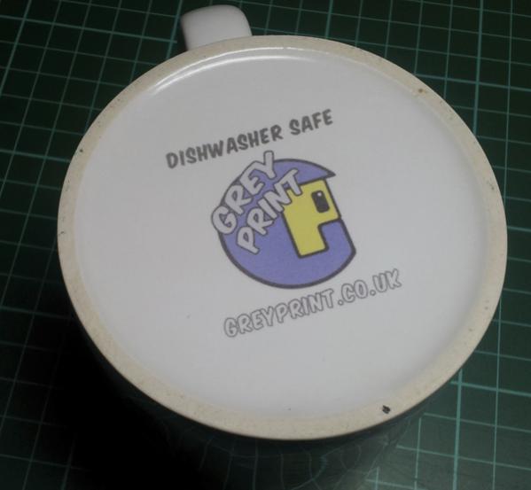

I wanted a message on the Bottom of my mugs so tried an Orca Coated Mug - no dice.
But then tried a Mug I got from our tall friend, they are labelled as Durham Sublimation Mug RG-381. I found that there IS a coating on the bottom of these Mugs.
Thought I would post this here incase anybody wanted to try it, obviously SOME mugs dont have the coating on the bottom
This solves the problem of getting my info somewhere as I was having no luck with stickers, which were intended to be peeled off.
I am using 125mm Plate element, a wooden block on the base of the press (to save the mug from shaming under the pressure) and Silicon sheet folded in Two but I think a thinker sheet will produce better results (more folds).

Either I need to build up my Puck more (I think it's nine sheets at the moment) or something else is wrong.

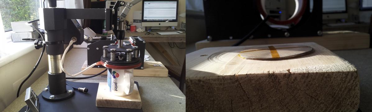

[ATTACH=CONFIG]2134[/ATTACH] The image will expand if you click on it.
I tried a combination of graduated Card disks to bulk it out and then Aluminium disks (From a Dr Pepper Can) as that would transfer the heat better (With silicon disks in between). I think I need to get more pressure as the first One I did (all the same Mugs) came out better with just Two sheets of Silicon BUT I am having to crank the pressure on my press which will surely make it fail sooner.
So, today I will find a way of delivering more pressure by designing a Puck which will do that evenly - and transfer the heat.
My existing *Silicon and Aluminium Puck is concaved. I think the amount of layers is dispersing the heat too much.
I have this set up the same as my mug settings for simplicity - 180 for 180 as it uses the same controller.

I think what you need is an aluminium disc - maybe 10 or 20mm thick and a single sheet of silicon. Actually the aluminium could be as thick as you like - the thicker the better, so long as it goes under the press, it would just take longer to get up to temperature in the first place. The bigger mass of aluminium will hold its temp for longer and just a single sheet of silicon would give you the best heat transfer as you really don't want to be heating the mug for too long. One sheet of silicon should be enough to take up the concavity of the mug base - so long as you are only putting say a 35 or 40mm diameter logo in the middle of the base.

I not have 9 disks of aluminium with a silicon sheet at the press side and at the Mug side for protection. now I have proved the concept I will find an Aluminium block - will have to light the fire in the workshop in this weather if I am to spend any time out there.
