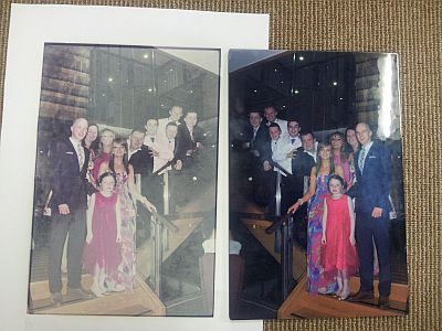

We have had problems today doing some Easel back Unisub boards,
[ATTACH=CONFIG]2085[/ATTACH]
Pressing at 200c / 60 secs
As you can see from above , we got a very poor result, .......we suspected that the pressure was not enough, so we increased it and did another one

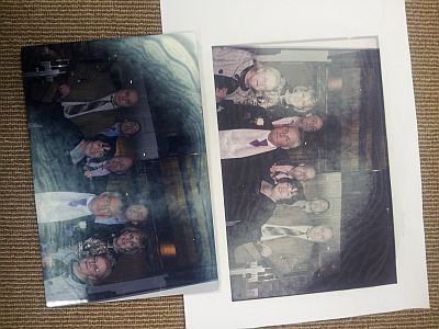

and got the following improved result
[ATTACH=CONFIG]2084[/ATTACH]
Which was a good improvement , but still not good enough.....the pressure was high for this .....(manual press)
I guess the poor result is because of poor pressure being unevenly transmitted due to the easel on the back of the 6mm board.
I was next considering making up something of similar thickness to the actual easel to sit alongside the easel , so that the full board is supported evenly ????
Does anyone else have a better way ??? Some tricks on this one ??

Re: Problem with Easel Back Boards
I believe it may have been Paul *but don't quote me on that* that mentioned cutting an old mouse mat or something to sit round the stand to make the back more even..
I definitely think that some makeshift back will be the way forward for you..
and low and behold........ video proof

Thanks for thatRenniwano;78705 wrote:and low and behold........ video proof
I just viewed the video...great stuff
Will have a go in the morning
Cheers
Tom
Thanks Again
Took a knife to a mousemat as per the video and it worked a treat.....perfect 1st time.
Cheers
Tom
