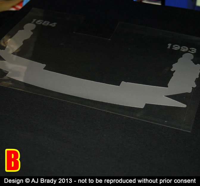

B: This is where the pressing starts and each colour layer has been previously 'weeded' (the term given when all vinyl not required has been pulled away) leaving just what is required to be pressed/printed. The Silver layer is the base layer (black will be placed on top) and I use a base layer (a layer always on the bottom) in most designs with multi colours.

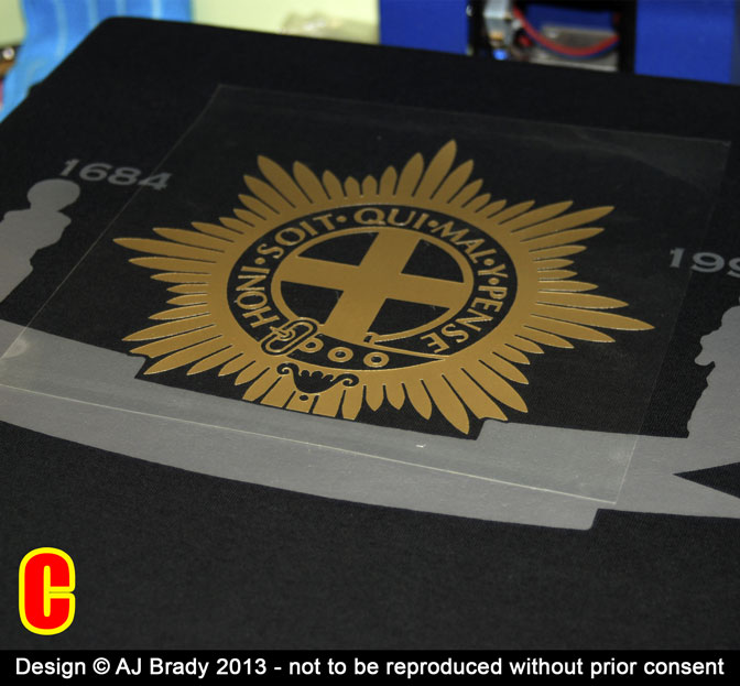

C: After silver has been pressed and peeled away (the vinyl has a heat activated bonding agent) I start to add the rest of the colours (this layer being gold).

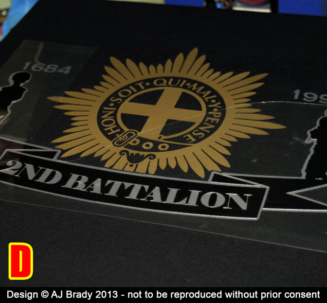

D: Next we have the black layer being placed onto the silver. Also, another note worth making is that vinyl will shrink if heated too much so it's a case of pressing for a few seconds to bond and then pull-away the carrier sheet.

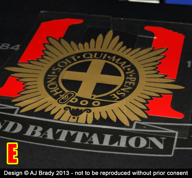

E: Next goes on the red flashes and you may noticed that each flash has been cut away so it fits like a jigsaw around the capstar, this is the photoshop process at the very beginning I mentioned - if it's not done correctly there then nothing will work.

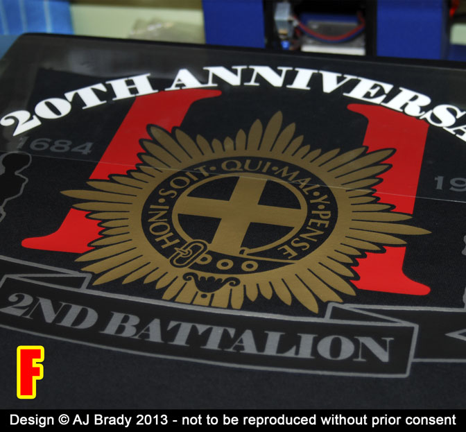

F: The first of the white layers in then pressed at the top of the design, and knowing that vinyl shrinks (remember stage D) it's a fine line to get it just right otherwise nothing will connect (i.e the bits won't connect on the final design).

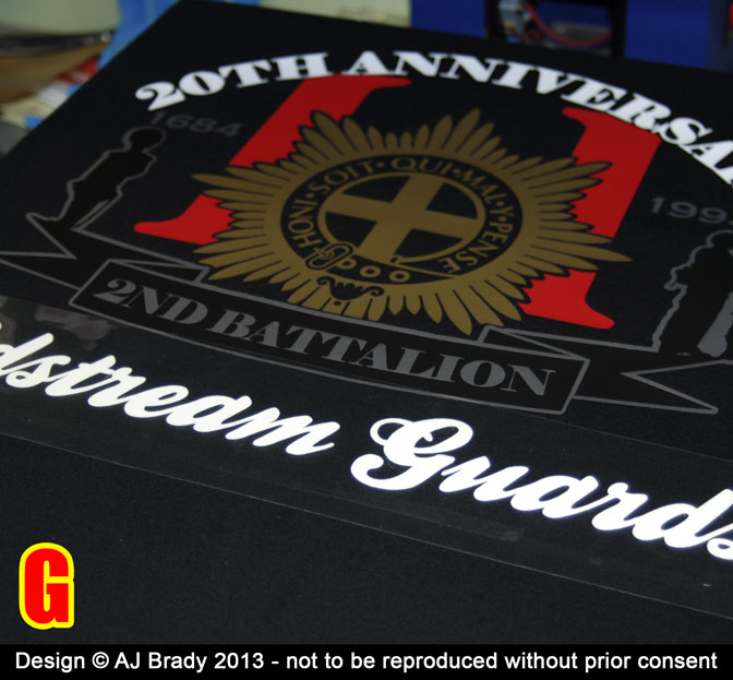

G: The second of the white layers is now pressed and you may now be thinking that there's a lot more to this than first expected - and I haven't even explained the process of 'weeding' yet (pulling off the vinyl that's not required) which takes time in itself.

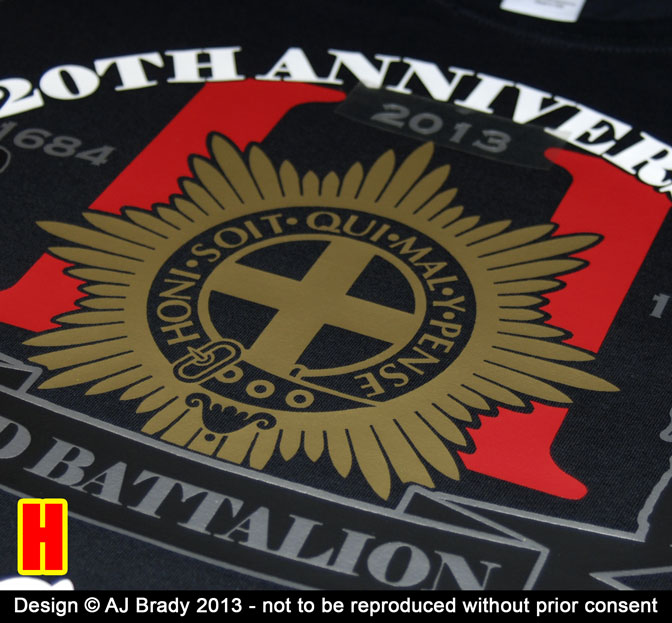

H: The final layer is the '2013' in Silver - which could have been done before the white but I chose to do this last.

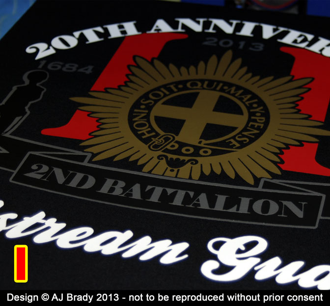

I: After all layers have been pressed the garment is then pressed for a longer period to make sure everything is bonded and secure. So, counting this final press I have now pressed this t-shirt 8 times (with all layers being covered by silicon sheets to avoid scorching).

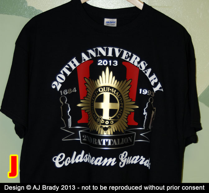

J: The finished print, all ready to be tagged and bagged ready for postage - easy eh!
