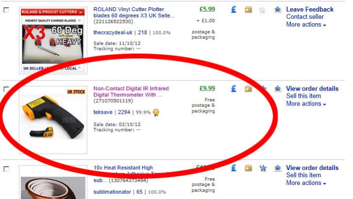

Checked on eBay and there are lots but none for £10. Do you have a name?
Re: heat press temp guide test
Mine was from this guy and it was £9.99 last week (see jpg screen shot). You may want to email the seller as he is now advertising it at £30.99!!!
