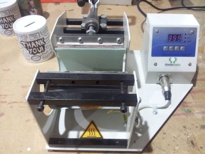

We are using a Ricoh printer and here is the press....
[ATTACH=CONFIG]1250[/ATTACH]
