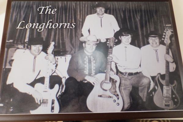

i have a 8 in 1 combo press that i bought from coralgraph a couple of years ago i have been having problems with pressing plaques as i seem to get a white spot right in the middle of my image, i have pressed 3 of the plaques and the same mark is there in them all at the same spot i am attatching a photo of the image if anyone has any ideas why this is happening it would be much appreciated, i preheated the plaque first before i pressed it, also i took the heat platen off my press and found that right in the middle of the platen there seems to be a small bubble there and what looks like a heat crack starting it sounds like the heat platen is going on me does anyone know where to buy a new platen for this heat press.

looks like uneven heat temp to me,have you done a temperature check on the platen

When i looked at your image again it could be low pressure spot.
We use a temperature heat gun which you point at spots on platen to check temp but i know you can get a temperature tape which gives a read out.
When we first started pressing slates had a similar problem so after making sure temp was ok always used silicone mat .

If everything else prints fine then it sounds like something isn't perfectly flat. Either increase pressure or get some thin silicon rubber sheet that's been discussed here before to spread the heat around and undulating parts of the press/ substrate. You'll need to increase the time to compensate for the silicon rubber to allow the heat to get thought. I'd aim for about 80-90 seconds with thin silicon (approx 0.5mm thick, longer if thick silicon rubber used).
