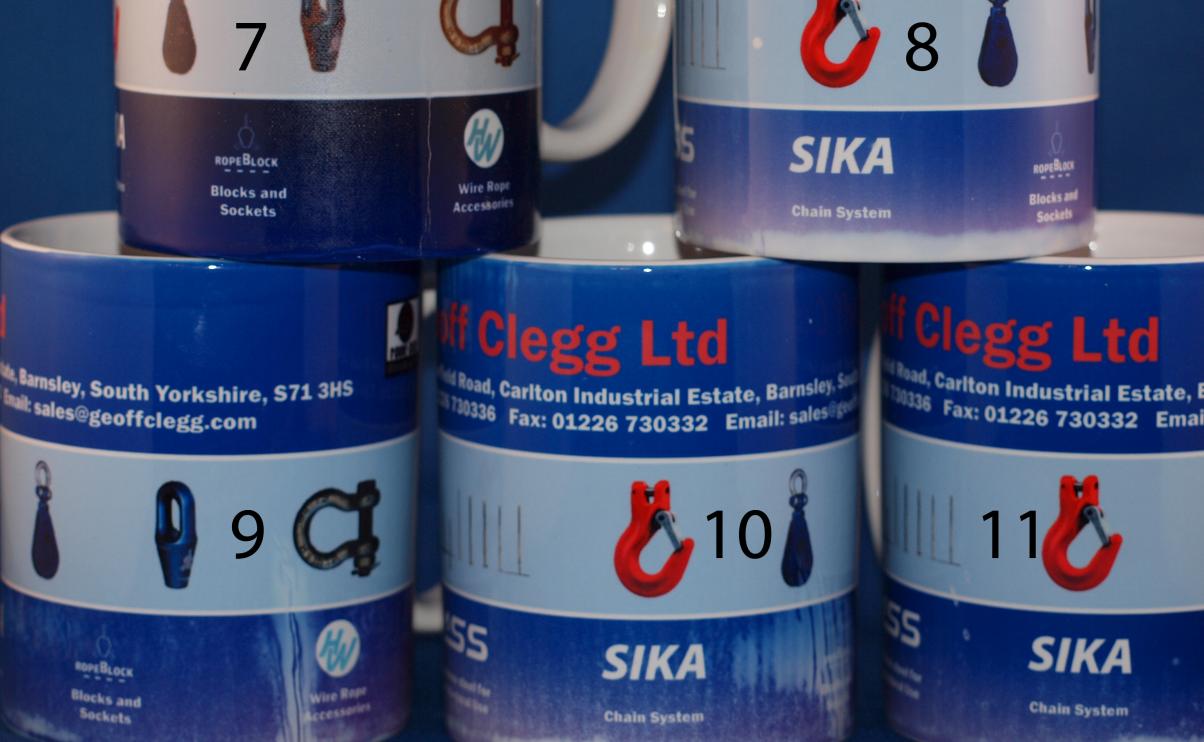

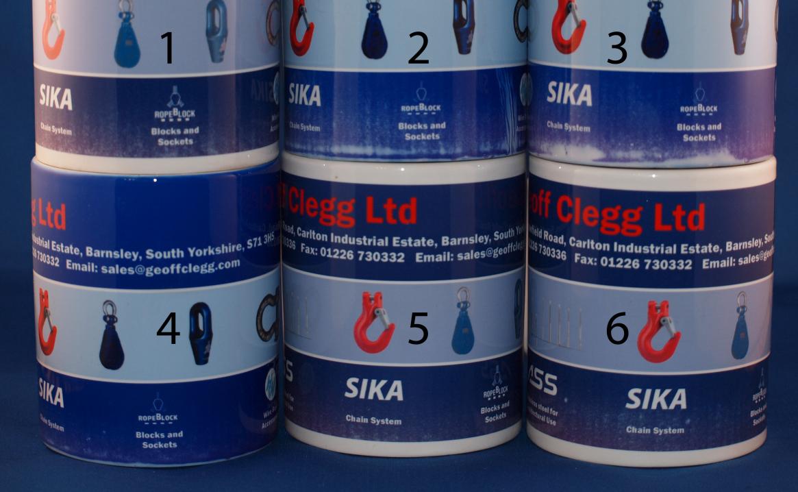

I have run the following tests with the results to be found in the images
1 Mug straight from box, 400 seconds, hot heat press
2 Mug straight from box, 180 seconds, hot heat press
3 Mug straight from box, 240 seconds, hot heat press
4 Mug straight from box, 350 seconds, hot heat press
5 Mug straight from box, 300 seconds, hot heat press
6 Mug straight from box, 325 seconds, hot heat press
7 Mug Heated in Hot Water, 350 seconds, hot heat press
8 Mug heated in Hot Water, 300 seconds, hot heat press
9 Mug straight from box, 120 seconds, turn over 120 seconds, hot heat press
10 Mug Heated in Hot Water, 240 seconds, hot heat press
11 Mug Heated in Hot Water, 300 seconds, hot heat press
Hot Heat press means that the press has run through 5 cycles to get the pads upto heat.
[ATTACH=CONFIG]429[/ATTACH]
[ATTACH=CONFIG]430[/ATTACH]
As you can see from the images the only consistency is the inconsistency and just when you think you are getting close, it throws a curve ball which lands you back at square 1.

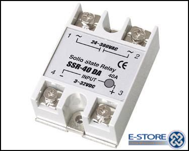

Very interesting review .May i ask how may solid relay system are in this mug press ?
