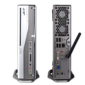

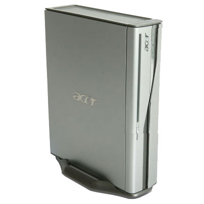

Been looking at someone's small format PC for them. It's an Acer Aspire L100.
Press the power switch, the light flashes, dvd drive powers up and that's it, no boot up. The dvd slot still works with the button so powers getting through.
Trying to eliminate possible problems, feeling is that there's a fault on the mobo but Acer want an arm and a leg just to test it and if it's the mobo it's expensive.
Anyone any experience fixing these small format machines?

The problem is there's no boot whatseover or I'd prob be able to work it out. Power light goes on and off and I can hear a slight hum from the machine but there's no boot so no bios/options etc.
^gstk - Small format PC so seperate case etc. doesn't work here I'm afraid.
[ATTACH=CONFIG]229[/ATTACH][ATTACH=CONFIG]230[/ATTACH]

There are no other working parts, it's a tiny itx Foxconn board with everything built on. I can soon put another cheap PC together but wanted to have a go at getting this one working first.
