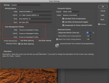

Are your Color Management settings set to 'Preserve Embedded Profiles?'

The RGB was set to set to "convert to working rgb" but the others were Preserve. Would this effect printing? When I print a regular colour chart using "printer manages colour" then colours come out vibrant and "seem" ok but when using old profile they are so dull. Obviously I know they will change slightly when heat pressed but even so they are too dark to lighten up and not like they use to be. Two days of no printing now.
