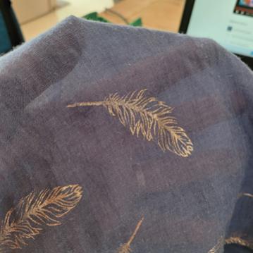

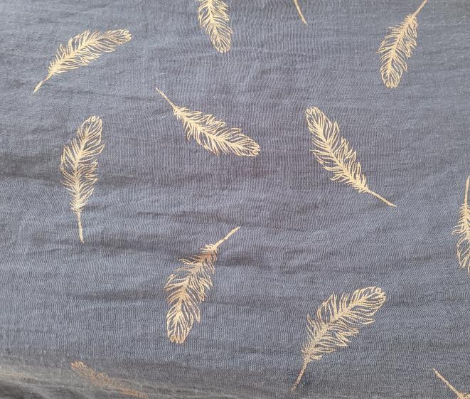

I am trying to work out how this scarf might have been printed. I dont think its dye sub.
Its a large blue scarf with shiny gold leaves all over it.
[ATTACH=CONFIG]7387[/ATTACH]

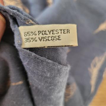

Its 65 polyester and 35 viscose and made in china
[ATTACH=CONFIG]7388[/ATTACH]
The print is like foil but its not and it lays on top of the weave not subbed into it.

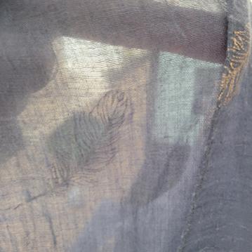

THe pattern is not on the underside but can be seen through the material

Might be rotary printed, which is basically a roll to roll version of sreenprinting.

Ah, ok. Not a home set up then :-)
