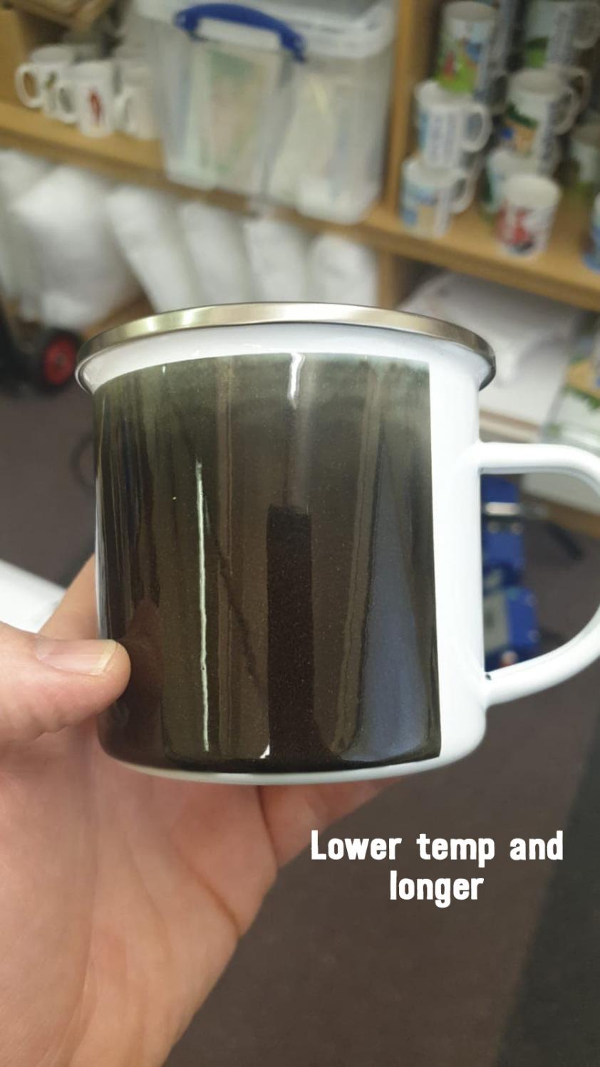

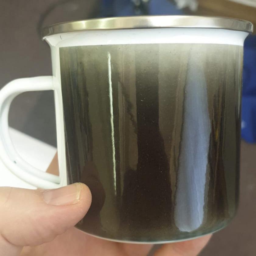

Any advice welcomed!
Have read previous posts on enamel mugs before posting this and I realise there is a difference in quality between suppliers.
Been asked to do some boxes of these for a customer and ordered from Novachrome. Getting an expected cold band at the top but worse than we thought it would be. Nova were great for getting back quickly with advice but alas situation has not improved by leaving for longer on a lower temp (was doing 200s @ 195c and tried 350s @ 185c). This is a test print with black band to show printable area and leaving for longer just left a patchy look on the block print.
Spoke to Neil Bros who said theirs had no problems but print company next to us said they had bad problems with them from there even in oven.
We press lots of other mugs including full colour top to bottom with no probs whatsoever so not concerned about the presses.
We would normally use xpres for mugs but we all know the chaos out there for mugs at the moment.
If anyone could give us any advice to get this sorted it would be appreciated :)

That is way to optimistic with the print area when using a press. Panel prints with clear white borders are what we tend to go to. Use the black prints to guide you on the parameters of what is realistic. Ovens are the only way to overcome the print area.
