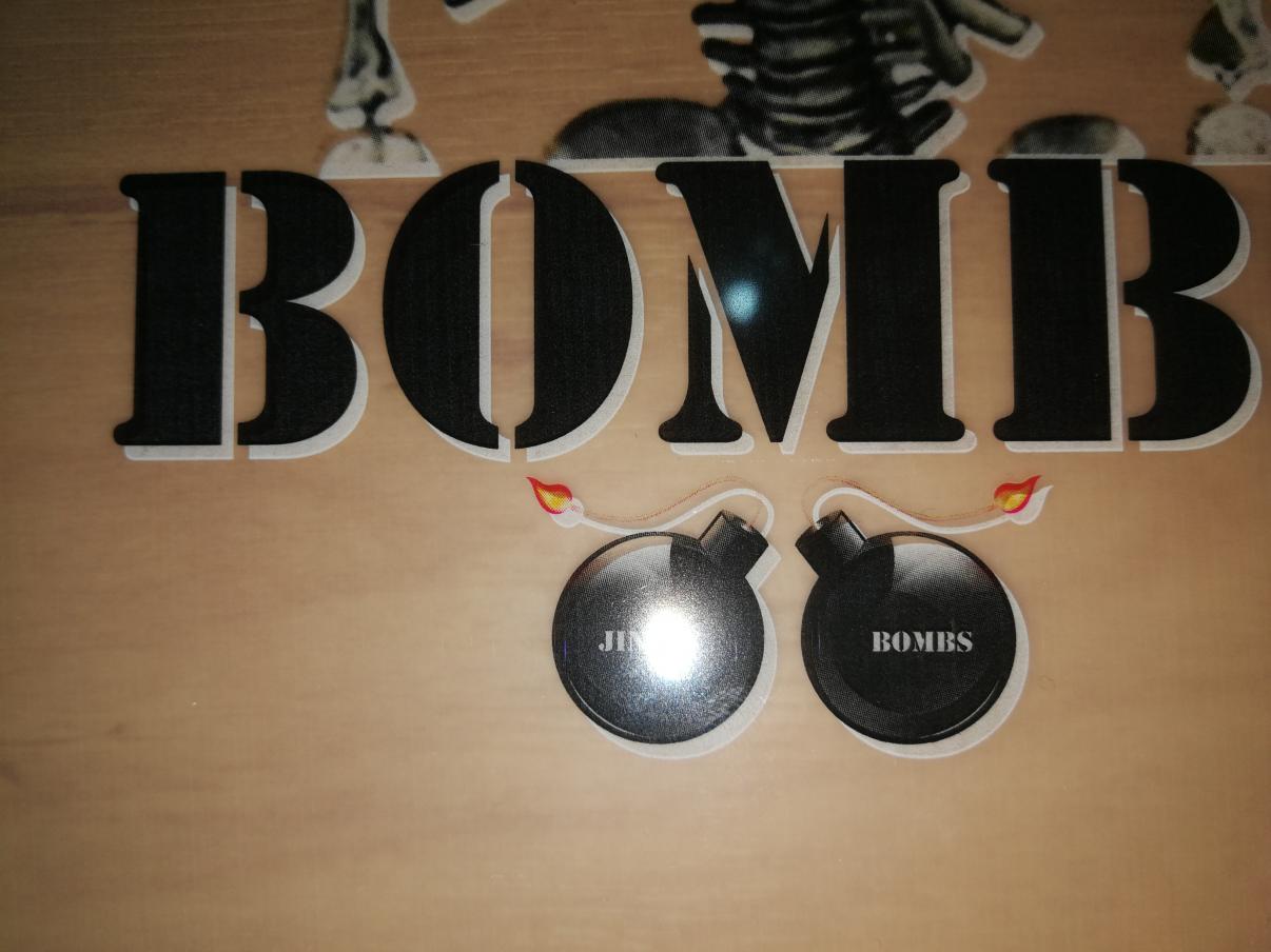

Hi Guy's Has anybody had any issue's with misalignment when you have to put white toner in as it goes back into the tray in the same position as the first print...this seems to keep happening to me half of the image is okay but the bottom half is always out of position is the anybody on here that uses ghost on here that can help please?

Azz;141475 wrote:Hi Guy's Has anybody had any issue's with misalignment when you have to put white toner in as it goes back into the tray in the same position as the first print...this seems to keep happening to me half of the image is okay but the bottom half is always out of position is the anybody on here that uses ghost on here that can help please?
I don't have one but I do recall reading that there is offset when you have to print the image again. 0.5mm was the figure given but I don't know for sure.

Hi Chonz I have tried this but the bottom image isn't lining up when i print.

Azz;141481 wrote:Hi Chonz I have tried this but the bottom image isn't lining up when i print.
Perhaps it's something else then.
I read on the Ghost Toner page that there is a 0.5mm offset when you print the second image, but yours looks bigger than that.
It looks like you are going to have to figure out the offset on your machine (measure it then narrow it down pixel by pixel, will waste some sheets) or contact them.

As you need to re-feed the media you will never be able to line it up exactly, Ghost tend to print nothing larger than A5 at any exhibitions I have seen them at. Better to spend the extra on Uninet or Oki white toner system.
