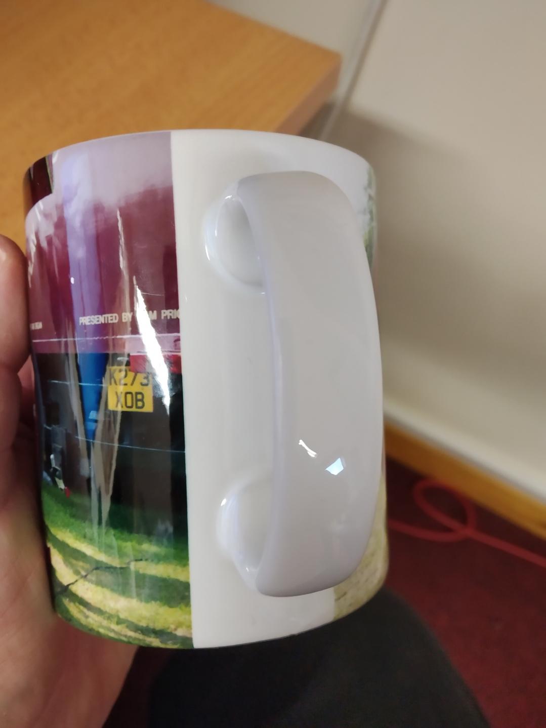

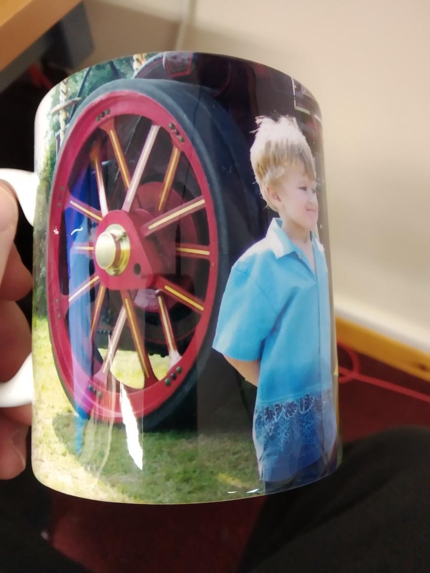

Re: Neil Brothers Orca Mugs
Sorry I thought you meant you were already using 5013's? I can see what you mean by the shape but we don't have any issues printing top to bottom.....
[ATTACH=CONFIG]5971[/ATTACH]
Pretty close to handle as well....

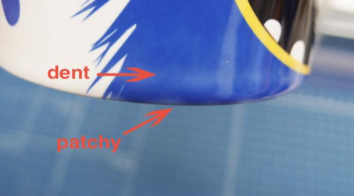

I've been using 5013 mugs again for the last week or so, but they have always had this dent travelling right round the bottom for years, about 5mm up causing a faded patch. The top of the mug will have a section where it hasn't printed either.

Personally I don't like full top to bottom and encourage customers to allow a 5mm gap top and bottom to complement the gap adjacent the handle, also obviously helps avoid this issue.

In this case Justin, it's the mug. You can see the distortion and shadow in the ceramic even before printing. It's too deep to print on regardless of the wrap.
