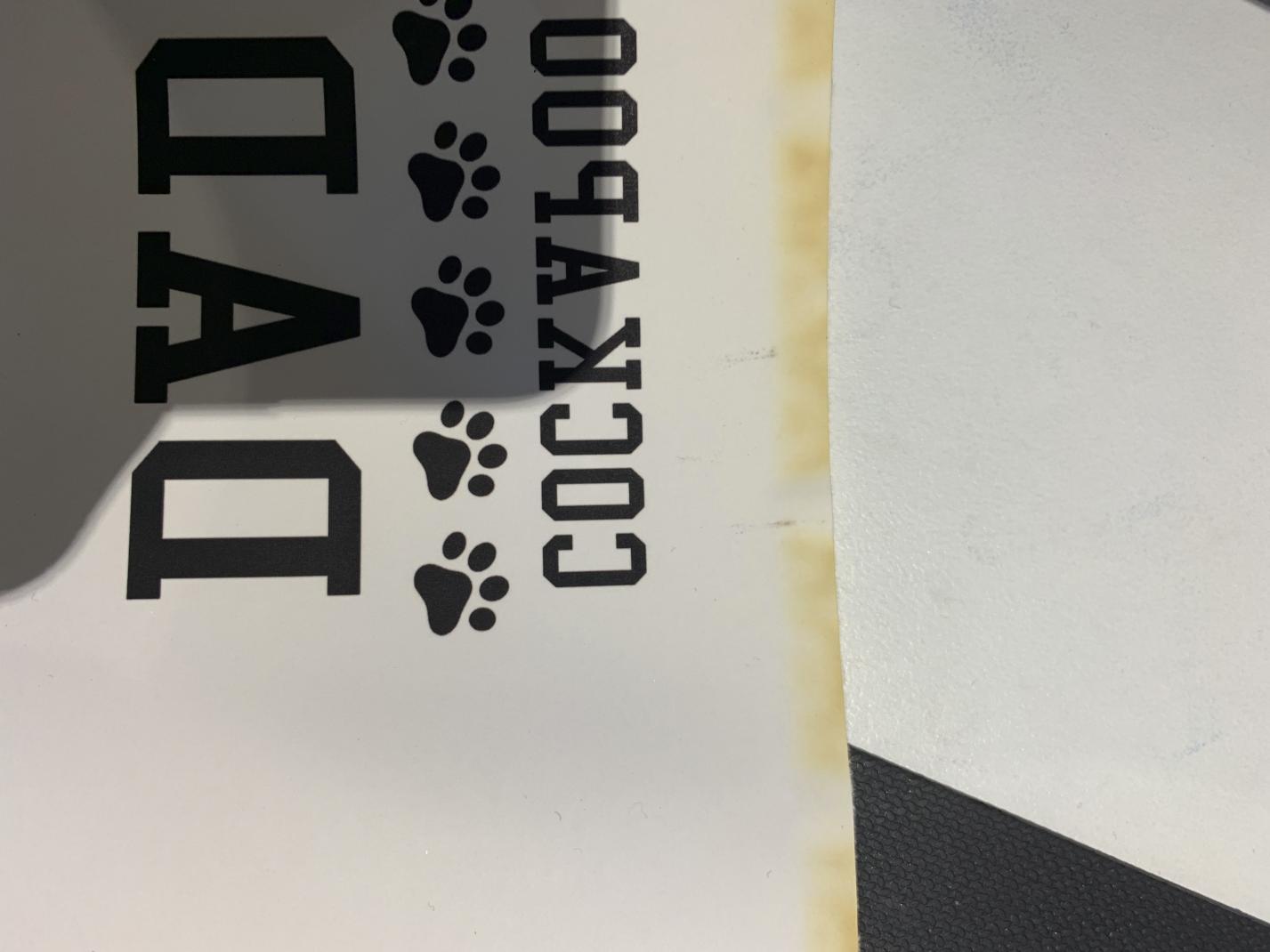

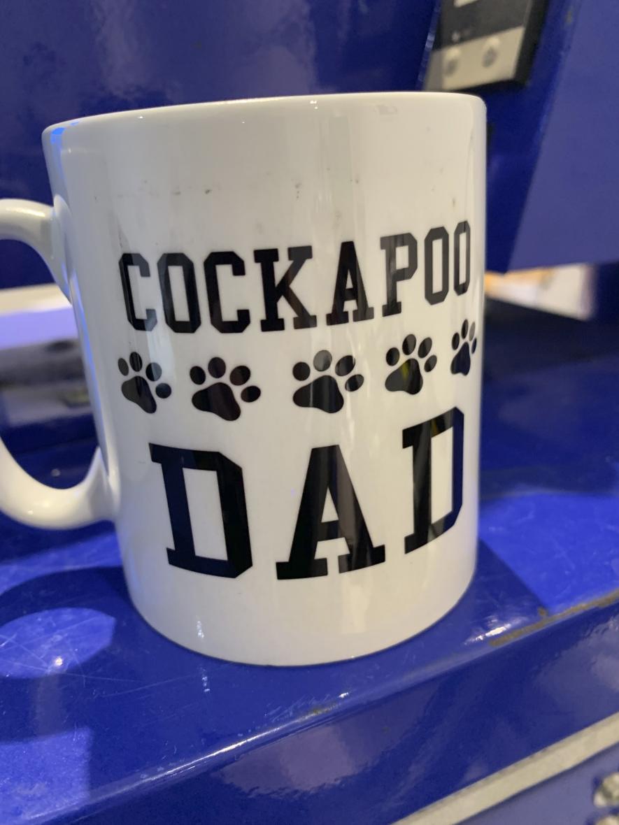

Hi i have just got a new epson printer and now getting issues when pressing mugs.
as you can see on photo above the text it is leaving so kind of ink marks on the mug these are not there on the paper before pressing so not sure to why we are getting this also see attched image of paper after pressing the marks seem to have appeared.
any advise would be highly helpful as its causing a-lot of issues
thanks

Re: Pressing issue ink printing onto mug that is not on the transfer paper
Looks like 'gassing out.'
Is your press gripping the mug tightly enough?
What condition is the press heat blanket in?
What time and temp settings are you using?

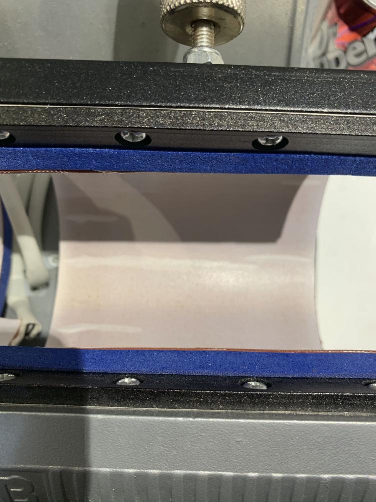

hi thanks for your reply please see attached image of the heat element does have a few bubbles in it could this be the issue?
press seems to have a good grip on the mug
press them is resting 160 then 180 for 100s when pressing [ATTACH=CONFIG]5942[/ATTACH]
Judging by the burnt edges on the transfer it seems to me that you are cutting your transfers higher than the actual mug. Try trimming them to within the mug height.
I'm no expert on heating elements, but those wrinkles look a bit suspect to me. I have a couple of mug presses and both elements are smooth. Anything that would cause the tiniest gap between the transfer and the mug will most likely result in gassing out,leaving those smudge marks on your mugs.
Thanks for your help will order new element see if this solves the issue (fingers Crossed)
