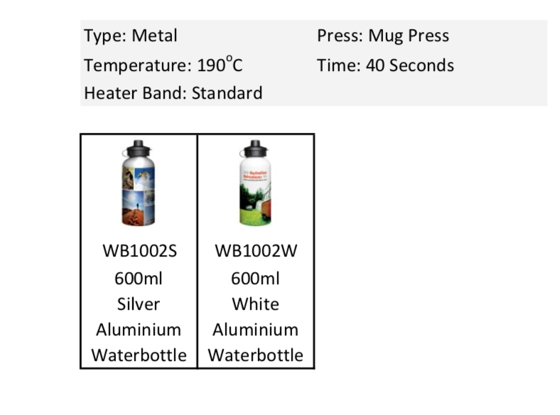

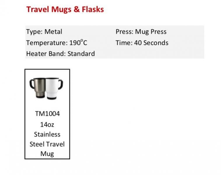

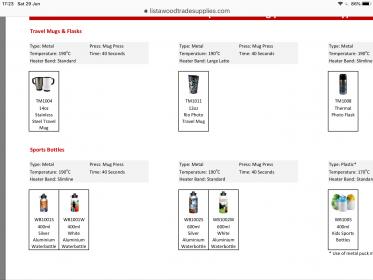

On the suppliers website (listawood) it says travel mugs and water bottles 190c for 40 seconds.
Yet other sites say 170-180c for 180 seconds.
which is it going to be?
i think 40 seconds is a little too quick but they are aluminium so maybe 40 seconds is right??

Sometimes you just have to try something and be prepared to scrap it if it doesn't work. That's how we all learned.
To me, although I've never done aluminium water bottles, 40 secs at 190 C seems about right, given that I sublimate to aluminium sheets at the same temperature for 50 to 60 seconds.

I will try the 40 seconds and see how it goes then.
