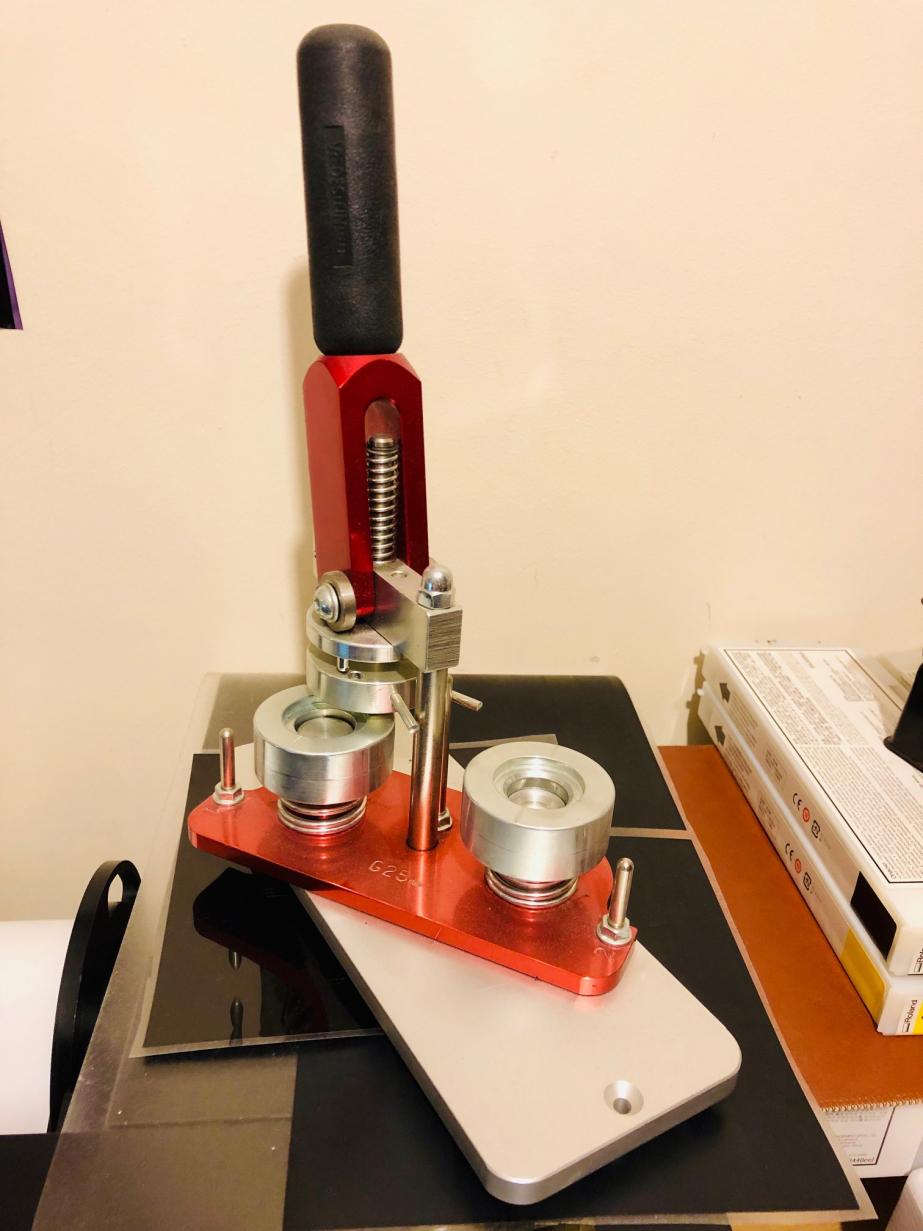

I use this.

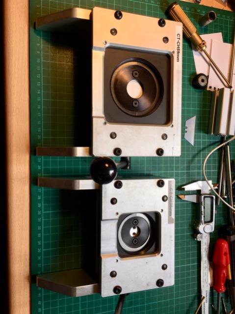

I use an interchangeable die tool from badgematic (Germany) as well as 2 fixed die presses from blankbadge (UK). Not all sizes and styles available from one supplier (at the time) hence using two. For cutters I have two lever types which are expensive but easy/comfortable to operate. I also use a brother scan n cut occasionally and badgematic supply precut blanks on an a4 sheet for laser printing. Quality is very good and once the page margins are adjusted for your printer they work really well and low cost. One thing to note is that some badge sizes are not universal and 1mm bigger will prevent a successful press so probably best to buy the cutter from the same supplier as your blanks..
