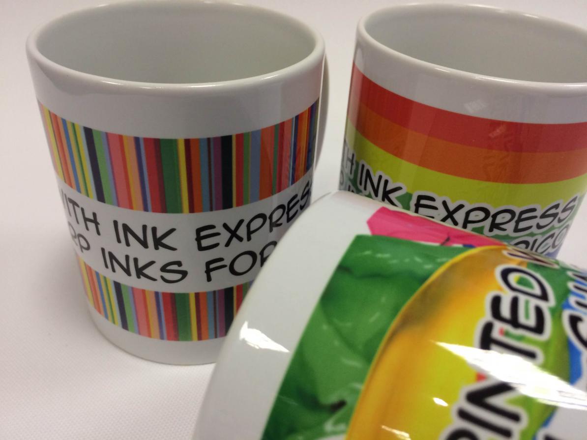

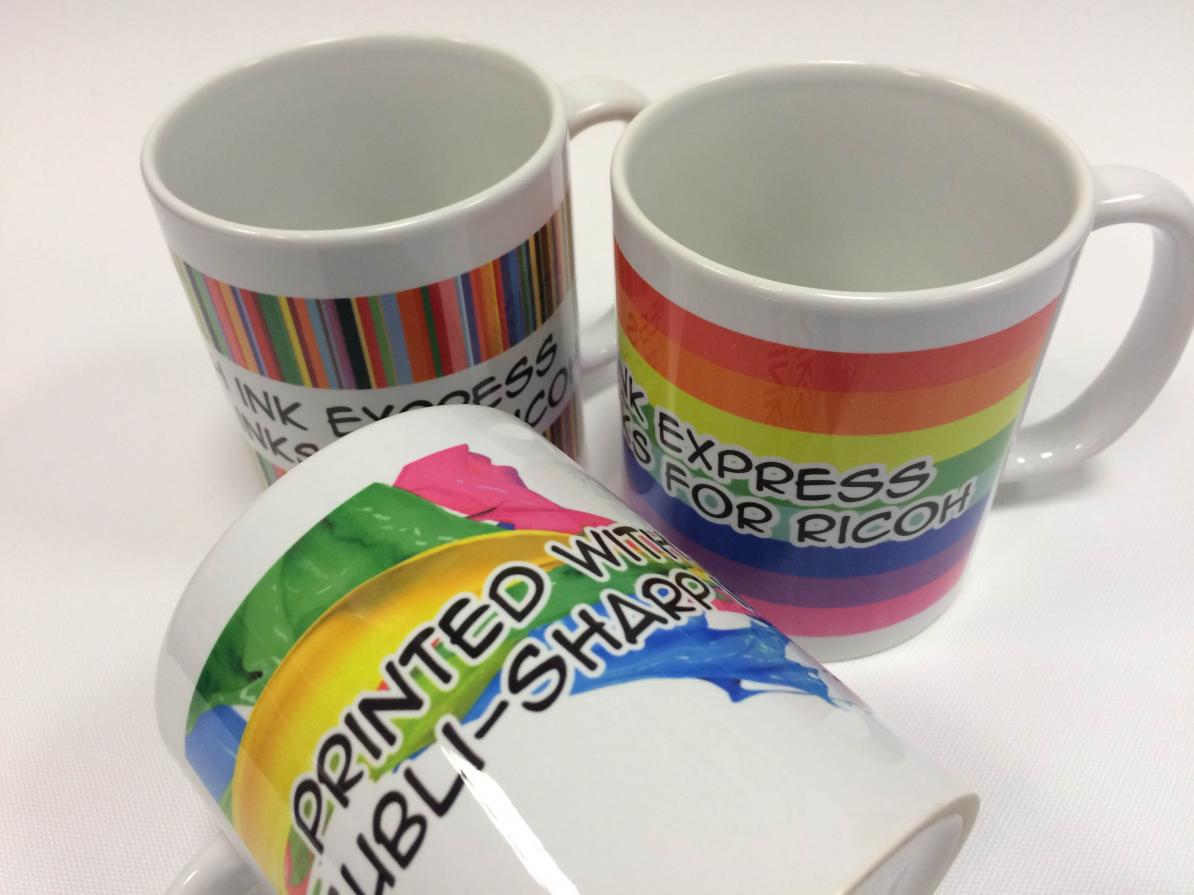

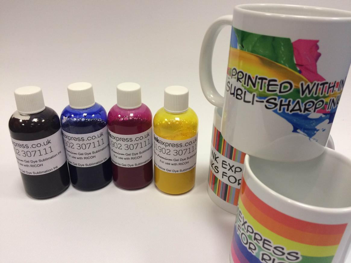

Bob, we have specific dye sublimation inks for RICOH printers that are of good quality and are manufactured for us in the USA. We have ICC profiles for that ink set and our paper that you are using.
I found RICOH printers were always a little flawed in how they printed even with ICC profiles but people who have purchased my inks and had the profile supplied (for free) have always given me good feedback and reports. Granted its not quite up to Sawgrass quality but at £39.00 for a set of 4 x 100ml its far cheaper and the price far out weighs the small variation in quality over Sawgrass inks.
Here are some mug samples produced using a RICOH SG2100N our ink set and our subli-sharp paper with ICC profile. As with all RICOH prints the red does come out a little orange but after testing 5-6 ink sets from various suppliers we found they all did this to a degree and put it down to the way the printers print.
Overall its a good ink set which produces good dense blacks and bright vibrant colours.
Alex
Alex
