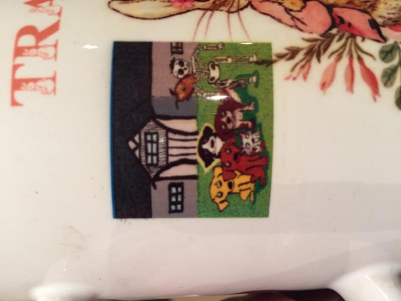

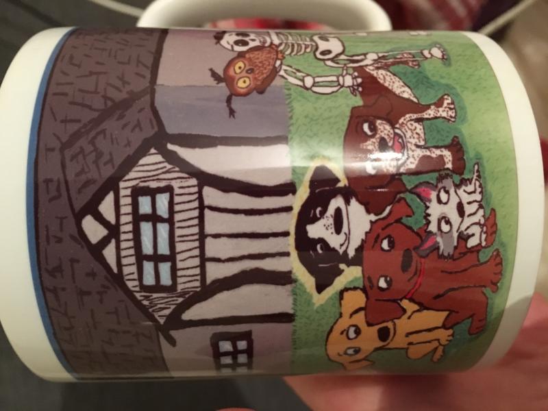

OK so I have now tried Illustrator cs2 (and set up with icc) and the same results the actual print looks ok now but when pressed it’s really dark the first image is of how the picture should look when pressed and the second is the new print! Same mugs same time temps.
